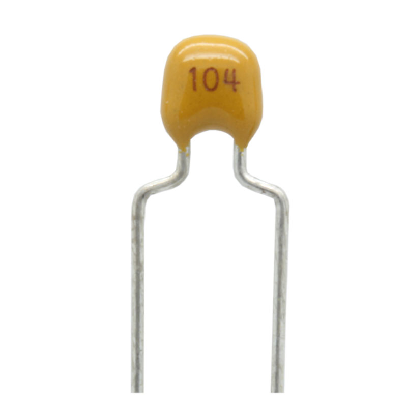

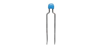

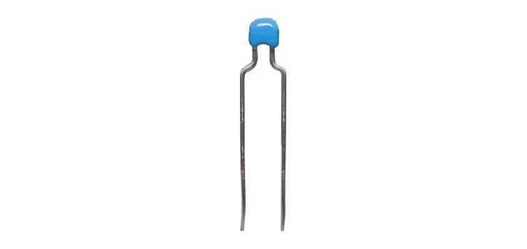

And another question: what kind of capacitor?
The longer the sensor wiring the more it can act like an antenna an pick up noise and interference.
0.1uF ceramic or monolithic will get you some nice small capacitors.
I'd add a 100nF decoupling right at each sensor (it won't do much good anywhere else). I've used a string of 20 of these sensors this way 24/7 with complete reliability. When you have a long cable visiting multiple sensors there's plenty of chance for noise and interference to get into the cable so decoupling seems wise.
