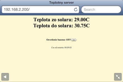

Thank you sir, that was the problem, working fine now :slight_smile: Only thing is that the temperature is now displayed with 3 decimal places, I would like to have only two. Is there any way how to round a floating point to two decimal places? But this is just the small issue. :slight_smile: I don't really need DHCP so I am not adding it unnecessarily.
Currently it looks like this:
float printTemperature(DeviceAddress deviceAddress)
  float tempC = sensors.getTempC(deviceAddress);
  if (tempC == -127.00) {
    Serial.print("Error, sensor not responding");
    Serial.print("C: ");
    Serial.print(tempC);
  return(tempC);
static word homePage() {
  long t = millis() / 1000;
  word h = t / 3600;
  byte m = (t / 60) % 60;
  byte s = t % 60;
  sensors.requestTemperatures();
  bfill = ether.tcpOffset();
  bfill.emit_p(PSTR(
    "HTTP/1.0 200 OK\r\n"
    "Content-Type: text/html\r\n"
    "Pragma: no-cache\r\n"
    "\r\n"
    "<meta http-equiv='refresh' content='2'/>"
    "<title>Temperature server</title>"
  "<h1>Solar temp out: $TC
 Solar temp in: $TC</h1>
<h3>Time since restart: $D$D:$D$D:$D$D</h3>"),printTemperature(outsideThermometer), printTemperature(insideThermometer),h/10, h%10, m/10, m%10, s/10, s%10);
  return bfill.position();
Entire code(excuse the use of non-english language): // This is a demo of the RBBB running as webserver with the Ether Card// 2010- - Pastebin.com
I think now it's time to consider implementing the pool lights control through this webserver. No idea where to start.
In that file EtherCard.cpp, the function "dtostrf()" is used to convert a float to a string.
https://github.com/jcw/ethercard/blob/master/EtherCard.cpp
In that file, 10 is used for the width and 3 for the precision after the decimal sign.
http://www.nongnu.org/avr-libc/user-manual/group__avr__stdlib.html#ga060c998e77fb5fc0d3168b3ce8771d42
Perhaps you can create you own buffer, and use "dtostrf()" in your sketch and use a string to get it into the webpage.
Worked like a charm, again :slight_smile: Thanks.
I also updated the code with a button for LED control(there will be relay for controlling pool lighting instead of LED). However, I find the code very "messy" but working. How should I tidy it up a bit?
Here's the current code(sorry, i am too lazy to translate it from my language to english, I think you'll get the point):

Hello guys, I was "upgrading" my project recently so I am seeking some advice again.
I added an LCD to my project for displaying temperatures from 3 sensors. LCD is working perfectly, however I have a problem with "webserver" part of the project. As long as I am displaying temperatures on LCD, the webserver is not working, there is no reply from webserver. As soon as I disable lcd.print part of the code, webserver is working again.
I think that the mistake is in the lcdprint() function. I think there is something wrong with two "delays" but I need them because I want to display two screens on my LCD, both of them should be displayed for 3 seconds.
I would be thankful if someone could take a look at the code and tell me what is wrong.

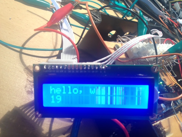

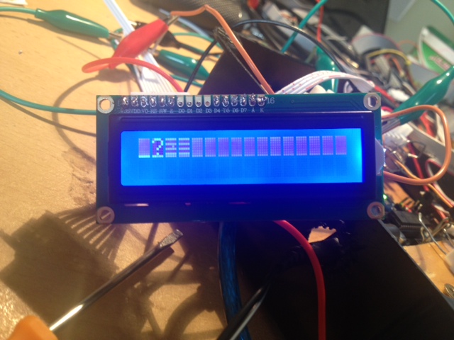

Guys, I was doing some wire tidying and I messed something up. I am trying to fix it for several hours now but I am out of ideas. I checked almost everything. The display has some unknown problem now, only first half of it is working. And that is only if I use wall adaptor for power, if I use USB power then the whole display is not working. What else should I check? I checked the wiring several times and everything looks to be connected correctly.
Edit: I found out that all temperature sensors are giving me 85C. I guess this has something to do with the first problem.
Photo with "Hello w" is when the wall adaptor is connected.
Any ideas whats wrong? :frowning:
That is what the displays do when they are broken.
It is hard to say what else is damaged.
