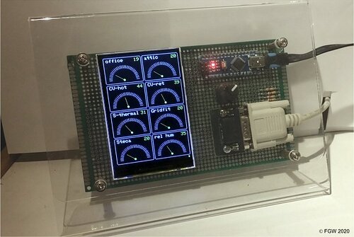

If you want to read a lot of DS18B20s and display the reported temperatures of each sensor, take a look at my blog, Multi temperature-humidity sensing with an Arduino Nano – TFT display: sketch updated. That one reads seven DS18B20 sensors and displays on a 320x480 TFT display
(Multi temperature-humidity sensing with an Arduino Nano – TFT display: sketch updated – thesolaruniverse)
There is a sketch attached at the end of that blog..
