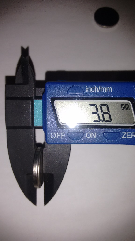

If your module is still original, check the battery voltage with the module powered by 5V, if your battery has a voltage greater than 3.3V, check the module circuit. Or just check the circuit. I found a module with a 4.3V battery and expanded body.
 ![Bad body.jpg](https://europe1.discourse-cdn.com/arduino/original/4X/6/2/5/62586aa3e71a81b0f424da0f0577ae102dc74136.jpeg)
Do not use an expanded body battery!
