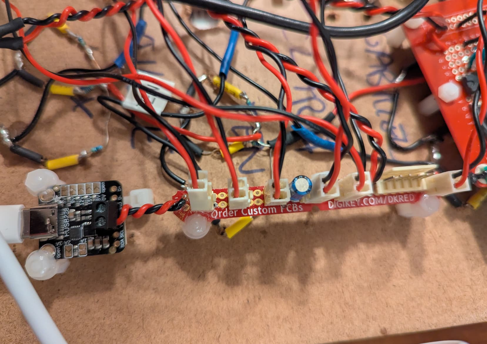

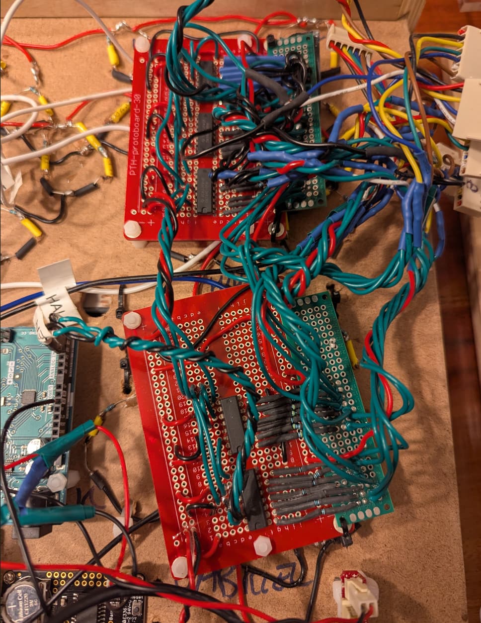

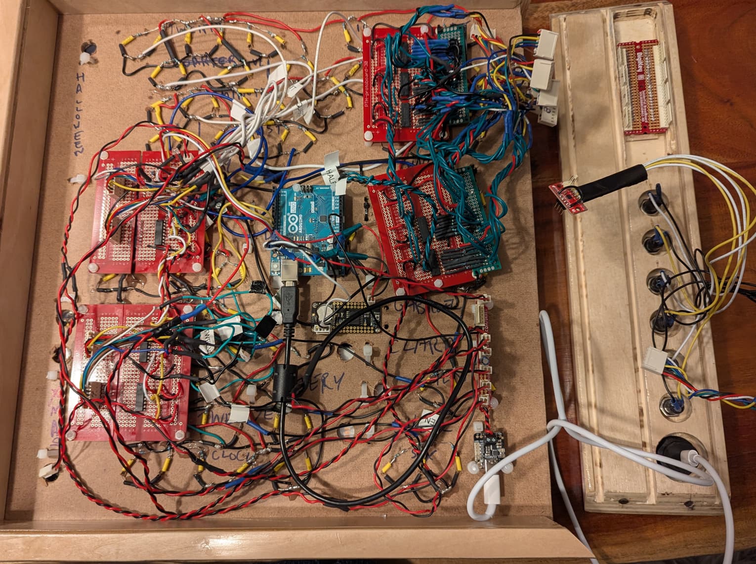

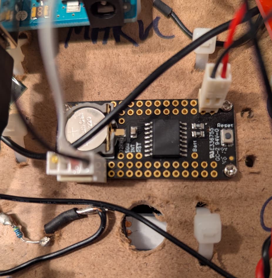

I'm a little scared to post images, for fear of the community's scorn because my wiring is very messy, but I guess I'll be brave and post some images...
This is the back of the clock. The two red boards on the left are the shift registers for the white LED words. The two red boards on the right are for 7-segment side-panel display. The Arduino is in the center, the RTC below it. The power rail is on the bottom right. The MUX for the buttons and the connections for the 7-segment display are disconnected (the problem manifests without them connected).
Beneath all the PCBs is a network of wires and resistors for the white LEDs, in a grid. The PCBs are raised off the back by about 1/2" via standoffs, except the RTC, which had nothing below it.
 ![image](https://europe1.discourse-cdn.com/arduino/original/4X/8/5/9/8598b8604de94476fa3543d74462fb8c87a830de.jpeg)
Here is a close-up of the power-rail:
 ![image](https://europe1.discourse-cdn.com/arduino/original/4X/4/6/0/46064b4f1fd087d3595764679da7377d06407dd6.jpeg)
Arduino (the electrical tape is from me adding pull-up resistors after-the-fact):

RTC:
 ![image](https://europe1.discourse-cdn.com/arduino/original/4X/9/3/2/9326d2e65ec4a48c1cad0c40cdbbe69bc471ab70.jpeg)
Shift registers for white LEDs:
 ![image](https://europe1.discourse-cdn.com/arduino/original/4X/d/e/0/de0b9835ed656a25154bdb1d3ca8c44aa6331d5c.jpeg)
Shift registers for 7-segment displays (x5):
 ![image](https://europe1.discourse-cdn.com/arduino/original/4X/8/1/6/81613b0a593a0fca466fca104a948f9844261408.jpeg)

> [@pyrkagemon](#):
> My suspicion at this point is noise on the SDA/SCL,
Seeing the wiring I would say your suspicions are correct.
> putting pull-up resistors (5-10k) between the SDA/SCL lines and the 3.3V line
In your case it would be to the 5V line not 3.3
Have you tried 4.7K to 5V?
