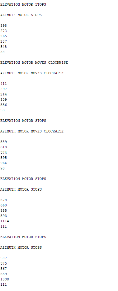

hi, after successfully running this program with the proper electronics (i.e. i used a power supply tester with the proper voltage and current settings), i've come to the conlusion that something in my code may not be cycling properly.
basically my elevation motor is listed in the loop first that spins clockwise and it briefly spun couterclockwise. however, when i cover up the other photoresistors the results show up in the serial monitor but they azimuth motor never spins and the elevation motor only spins clockwise.
any thoughts?

Why not add some "Serial.print"s to see if your outputs to motor controller are what's expected?
If clockwise is down, does the motor have enough "grunt" to raise the panel?
EDIT: Or, write a "manual" sketch and work the motors through the serial monitor to see if they're up to the task.

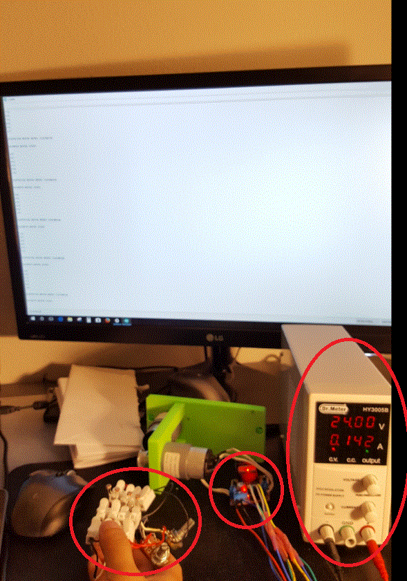

Hi yes I will update the code soon with this thanks.
One other thing, you're starting the motors at reduced PWM (200), you may have to "kickstart" them with a burst of full speed (254) for, say, 30 - 50 mS to get them out of their own tracks, then drop back to desired speed.
Good point I think I had it like this before with the solar panel.
Then I thought to myself maybe i am drawing too much current that the panel can't supply it simultaneously for both motors and that's why they can't move.
Now I have a power supply to test with (can supply 5 amps and up to 30 volts) so I'll keep everyone posted.

Turns out it was not a programming issue after all it was just motor power issue and the battery is helping out..
Here is the latest code for reference:

  Serial.println("   ");
  else if (-1*tolerance < dv || dv < tolerance) // if difference is smaller than tolerance, STOP elevation motor
  digitalWrite(in3, LOW); digitalWrite(in4, LOW);
  Serial.println("ELEVATION MOTOR STOPS");
if (-1*tolerance > dh || dh > tolerance) // check if the difference in left and right LIGHT SENSORS is within tolerance range
  if (avl > avr) // if average LIGHT SENSOR values on left side are greater than right side, azimuth motor rotates CLOCKWISE
  digitalWrite(in1, HIGH);  digitalWrite(in2, LOW); analogWrite(enA, 254);
  Serial.println("AZIMUTH MOTOR MOVES CLOCKWISE");
  else // if average LIGHT SENSOR values on right side are greater than on left side, azimuth motor rotates COUNTERCLOCKWISE
  digitalWrite(in1, LOW);  digitalWrite(in2, HIGH); analogWrite(enA, 254);
  Serial.println("AZIMUTH MOTOR MOVES COUNTERCLOCKWISE");
  else if (-1*tolerance < dh || dh < tolerance) //if difference is smaller than tolerance, STOP azimuth motor
  digitalWrite(in1, LOW);  digitalWrite(in2, LOW);
  Serial.println("AZIMUTH MOTOR STOPS");
  delay(delaytime);
I just wanted to give anybody that may be interested an update.
I WAS ABLE TO GET IT TO WORK WITHOUT BATTERIES AGAIN!
;D
A few things I've changed:
  1. I'm using a BTS7960 43A H-bridge High-power Motor Driver module
    (One for each motor, the L-298 H-bridges are known to inefficient and have voltage drop issues)
  2. My PWM settings are maxed out at 255 now.
  3. I'm not sure if this could have been an issue but there are more pins with this driver vs the L298 and
    there are enable pins for each direction of rotation, I'm wondering if these enable commands may
    have needed to be changed in my previous code using the L298 motor drivers.
Positive outcomes:
1.I'm using new motor drivers that can support up to 43 Amps.
  1. I don't need to complete a ground connnection from these drivers to the arduino because they have an
    independent MCU. (One less wired connection that I have to make.)
https://www.aliexpress.com/item/Double-BTS7960-43A-H-bridge-High-power-Motor-Driver-module-smart-car/32819713287.html?spm=2114.search0104.3.16.Aeze26&ws_ab_test=searchweb0_0,searchweb201602_3_10152_10065_10151_10068_10130_10084_10083_10080_10082_10081_10110_10178_10137_10111_10060_10112_10113_10155_10114_5360015_10154_438_10056_10055_10054_10182_10059_100031_10099_10078_10079_10103_10073_10102_10189_10052_10053_10142_10107_10050_10051,searchweb201603_1,ppcSwitch_2&btsid=38950507-5a4b-4484-b927-b6aca95b799f&algo_expid=fe72560b-bae7-4787-858d-8ec79aa9426b-2&algo_pvid=fe72560b-bae7-4787-858d-8ec79aa9426b
I am using a small 5V solar panel to power the arduino.
I tried both my small 6V and 12V panels for my 6V motors and 12V motors.
Things move for sure.
Adding a battery would help for cloudy days.
I can tell the motors are not always running at their max torque/speed settings on cloudy days.
