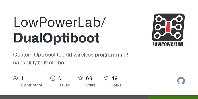

I am messing with dualoptiboot and so far I can get it to read the SPI flash chip and flash garbage to the mcu so it crashes next reset.
I have confirmed this with “FLXIMG:06:FFFFFF” in the flash chip and debug enabled so I can see that it recognizes the “sketch” in the flash chip i. e. finding “FLXIMG” and that it goes past the check to see if the number of bytes is even. And also re-flashing the mcu cause next reset it crashes and flash chip is erased.
https://github.com/LowPowerLab/DualOptiboot
What I am having a hard time with is…
