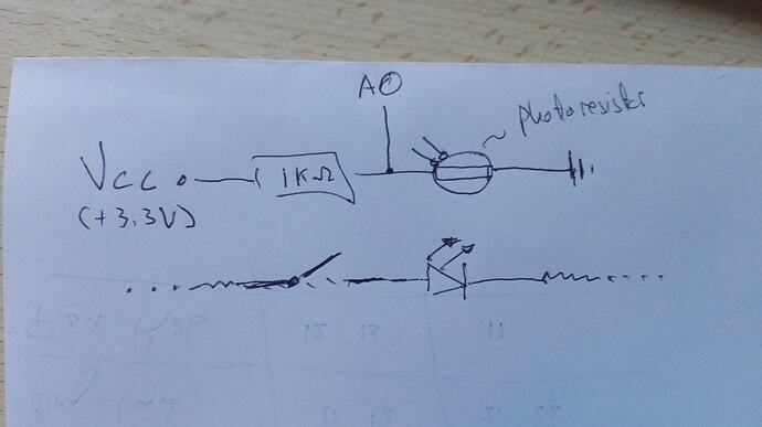

The circuit is very simple. A resistor in series with a photoresistor and then ground. In front of the photoresistor there is a blinking led. So in serial plotter a kind of square wave should be observed. However the valued measured was always constant despite the switching on\off led.
This experiment worked perfcectly in an arduino UNO, so it isnt a circuit problem. Also triying differnt analog ports didnt help. And with analogReadResolution the number shown was bigger but always constant.
I hope there is somthing im missing and not a board issue. If you have any idea or recomendation let me know
Diagram, please.
AWOL: Diagram, please.
Done! But there cannot be a simpler circuit than that haha, and it Works very well in an UNO

Maybe not, but there could have been a better description of it

When i move the potentiomer the only values that are returned are 512 or 768, and if i read from a pin without anything connected it shows as 512 constantly. I dont knowm, maybe there is a shortcircuit somewhere in the board???
What happens when you short it to ground?
Which version of the IDE are you using? Can you try another version? Use another analog pin?
AWOL:
Shorting to vcc shows 768 and to ground 512. And i just tried this potentiometer before with the UNO and works fine.
Sounds like you broke it.
