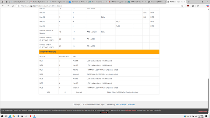

Hey! I got my hands into a Leonardo board a couple days ago, and i've been trying so hard to get dc motors running, i cannot figure out where's my mistake the code seems to be right, i know it's a dumb problem, any tip is helpful at this point. Thank you!

I have two motors connected, ML1 and ML2 (correct me if sent anything wrong, im'm completely new)

This board is arduino compatible. If you are using the Arduino IDE you must select the Leonardo board to upload the code. You can program this board of three ways at the moment:
  • MRTScratch: In scratch mode directly
  • BlockyDuino: Firstable you must create the program with blocks and then the code must be loaded in Arduino
  • Arduino IDE: Directly in C code.
MRTDuino Board – Robótica Educativa Logix5
What is it exactly ?
Can you please post a link to the device that explains what it is and how it is used
It is a MRTduino

Perhaps try this.

According to this ML1 and ML2 are ports 14 and 16. Never programmed one though so? ,Well I ain't a pro. :sunglasses:
Finally got those mfers running. Why does it have four dc motors outputs if the motors shouldn't be connected there??? Honestly im kind of upset of how dumb this is, but at the same time i'm pretty happy with the results. Thank you so much for your time and patience!!
If you turn dip switches 1-4 on the DC motor ports may work. In your picture they are off.(Turn them all on for that matter)
