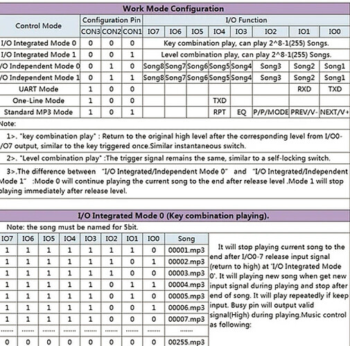

I have a Dy-sv8f
I've wired pins
IO0 to button 1
IO1 to button 2
IO2 to button 3
I would like 6 in total but if I name one mp3 file 0001.mp3 it plays from pin IO0, if I name a file 0002.mp3 it plays from pin IO1, if I name a file 0004.mp3 it plays from pin IO2, meaning if I rename 0004 to 0003 it won't play, and if I add more mp3 files and name them accordingly in numerical order they won't play, only the first 3 buttons will work but files names are 1, 2 and 4
I'm quite new to this so any help would be greatly appreciated as I'd like pin 0 to play mp3 1, and pin 1 to plays mp3 2 and so on
I just want 6 push buttons to play 6 MP3's

You have the DP switches set wrong (the 3 red switches):
Should be like this:
So with number 2 up it should work?
yes

4
Hi.
Problem solved. In many trials, the solution is in the key pin numbers.
You can use the picture below for combinations.
Thanks...
