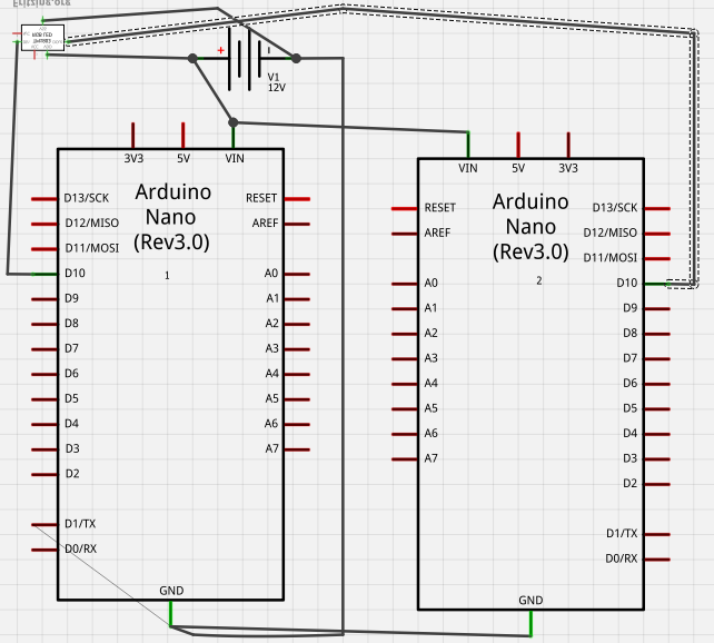

Maybe this will help. I am actually working on something with this stuff right now so I had it in Fritzing anyway. This image is a little confusing but it's basically what you describe, with a second controller at the end of the data line. In this example, there's only one WS2812, and its "Dout" pin is connected by the highlighted wire to the digital pin on the controller on the right. Data comes from the controller on the left.
What will happen here is, if you send 24 bits and then the EOF signal, the Arduino on the right will never see anything. The line will remain low the whole time. If you send 48 bits, enough data for two lights, the WS2812 eats the first 24 bits while leaving "Dout" low, then when it sees the 25th bit it passes that bit to the Arduino in our case, in most cases, to the next WS2812. So, we could send 24 bits for a test, get nothing, try 48 bits, see data, and know we only have one WS2812. The important thing to remember is that each WS2812 sees nothing until the previous chip has seen 24 bits of data. Once it sees 24 bits, it passes all the subsequent data on the "Dout" line.

your image is intriguing. but it would require a loop of some form. there is nothing attached at the end of the strand. and only utilizes three pins. The attached image displays four pins, the two center pins are grounds. I'm a bit upset that they scraped off the info of the chips, but the first chip is an atmel chip for the RF receiver. the other two are essentially attiny components. (not actually attiny...but essentially the same thing).

In the image I posted, notice that there are four things connected to the WS2812 - power and ground, data in and data out... data in is connected to the left controller, data out to the right controller. This setup would work, and the right Arduino could see the data, except for the first 24 bits in each frame in this case. The LED strips would be the same circuit, but more WS2812s in between.
