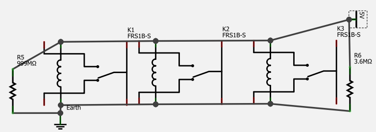

In Ground Loop 2.png, I took a GND lead from my Arduino, connect it to another GND lead via 3.6M ohm resistance. I tried to measure a voltage across the resistance (2 1.8M ohm resisters in series).

Let's look at your first diagram there, with the two high-value resistors to ground. Imagine that top line is like a strip of copper on a PCB. From that line, let's say you have the ground side of the coil from five relays in a row, which are clicking away independently. Every time one of those relays turns on, there is current flowing through the coil, to that trace on the PCB. If the center relay is on, what's the voltage on that trace? It should be zero, with reference to ground, because it's connected to ground. But it won't be, because there are fat resistors between the relays and the real ground point. This is an extreme example, because your ground reference will hopefully have less than M-ohms of resistance. But even if it's 1 ohm, will the voltage on that top line be exactly 0v? Nope.
So, if that center relay is on, dumping 5v into a high-resistance path to ground, what does that mean for the relays on either side of it? What is their reference? Current prefers to flow where there's lower impedance, so it'll flow more toward the side with the lower value resistor. Now there's a difference between the ground reference of the leftmost relay and the rightmost relay. If this offset is high enough, there may not be sufficient voltage difference between the + and - side of the coil for it to engage.
It can get worse if we used that line on the PCB to connect another circuit. Imagine we connect it to an LED with a 220 ohm resistor straight to ground. 220 is a lot less than 100M, so the relay current will flow through the LED to get to ground. (This is a heavily contrived example, but it illustrates that current may flow through a path we didn't intend if it's a lower resistance path.)
The point of all this is, you can't treat a ground as a black hole. Every connection has some amount of resistance. Ideally, every ground in your circuit has its own, unshared connection straight back to the reference point. That way, every component has the same base voltage to compare with. (This is known as star grounding.) That's rather impractical in most cases, so instead we commonly use large ground planes to minimize the resistance, which is the second best approach.
The absolute worst approach is to have a bus ground, like the imaginary trace on the PCB with relays attached to it. The potential will be slightly different at every point along that bus, which could mean instead of going straight to ground, there may be times where the easiest path to earth is through some other component with a lower resistance to ground. Or, some component may not be working the way it should because the voltage across it isn't what we inteded it to be.

Yes, right.. See the picture I've attached. This is more like how I pictured it. I chose more reasonable resistances of 100 and 3.6 ohms, rather than 100M and 3.6M, because with a 5v source, in reality, those relays will never turn on. The triggers are 5v square waves, at different frequencies, so they turn on and off independently. (This was an illustrative point I made in the last post, but otherwise not important.)
If the + terminal is 5V, the voltage across the relays won't be 5V due to the resistors, I think.
Right. The coil has its own resistance, so it's essentially a voltage divider.
But, the voltage in the parallel circuits should be the same, or am I wrong again?
If the trace on the - side of the coils, between the resistors, had 0 ohms resistance, then yes -- the voltage at the top end of both resistors would be the same (and current through each side would be relative to its resistance). But that trace does have some resistance, so it will affect the voltage at each end. By how much is proportionate to how much current is flowing. In most cases, not much different, but if you're dealing with long / thin traces, high current, or very low voltages, it's significant enough that you need to know it's there.

In Ground Loop 3.png, there would be a difference in earth reference between the left relay and the right relay, correct? So the voltage across the relays are not the same as each other.
Well, I didn't intend for the resistors to be parallel to the relays when I wrote my last post, so your diagram 3 has the advantage of having a low-impedance ground reference. My last post assumes the absurd 100M and 3.6M values between the coil - pins and ground. (Again, the relays would never actually work this way, it was just an example.) The voltage through the coils would be nearly exactly the same. The only thing that prevents them from being precisely the same is variance in the coil impedances (tolerance), and the imperfect nature of the ground bus beneath them. To help understand the last part, imagine those traces as very low-value resistors, not a straight line.
Since the connections between the relay grounds is not perfect, there will be voltage on the ground bus between relay 1 and 2 if relay 3 is on, for instance. This affects relay 1 and 2's point of reference, because the + terminal is no longer with respect to 0v. It's with respect to 0v + the voltage across the ground bus.
The better way to design a PCB based on your latest diagram would be to put the ground connection under relay 2, so it's (closer to) equidistant from each of the relays. If you have a fourth relay, then you can align them in a square, with the ground lead in the middle. Or, just make that PCB trace fat enough that its impedance is so low that it doesn't affect your circuit.
We've gotten away from your original quandry (why the capacitive sensing doesn't work from a battery). I don't really know how to help with that specifically, since I've never tried to do it myself. All I have is theories, and I'm not sure all those are correct, or if I've explained everything right. I often find out how much I still have to learn by trying to explain my thoughts to someone else, so I might get schooled here soon. :slight_smile:
