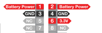

Check the AB outputs with an oscilloscope. Do you see any activity?
Is the power to the RS485 chip controlled by the libraries, or do you need to manually switch it on using the example in the documentation?
These libraries are specifically designed to be used on the MKR series of Arduinos together with the RS-485 MKR shield. I doubt that they work out of the box with your RAK board which isn't the most common board used on the Arduino platform. I suggest to use another Modbus library (p.e. ModbusMaster) where you can specifically tell the library which serial interface to use and how the enable lines are managed.
Post a link to the platform core you're using (I didn't find one with a simple search) as well as a wiring diagram!
Also post the correct code again, the one in your post isn't complete.

If the circuit diagrams on the web site are correct then you need the
pinMode(WB_IO2, OUTPUT);
digitalWrite(WB_IO2, HIGH);
to turn on the 3V3_S supply which appears on pin 6 of the IO extension slot (and is incorrectly labelled 3V3).
Currently you are probably powering the transceiver via its signal pins.
Your wonderful. Why didnt I realise that!! Its working perfectly. Now I just have to decode the 2x 16-bit = 32-bit registers and get some sensible numbers. Again, many thanks for your help. I am very grateful.

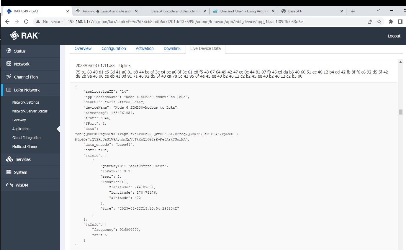

The RAK7249 gateway server shows the payload on its screen. I wont show it here. It is more appropriate to Priority_3 and the problem Im having there. Regards

I have a BASE64 decoding issue. I would appreciate any help or advice as to what the prblem is.
Here is Serial.print() scren shot of the output from the above code.
I have printed the message in the payload, 7th line down. This is identical to the payload shown on the RAK7249 gateway server. Here is that output screen shot.
You can see the payload about halfway down. (I dont know how to annotate the screen shot! Sorry.) Clearly the two message/data printouts are the same so that tells me that the MQTT is receiving the correct data from the gateway.
You van also see in both printouts that the fCnt 6846 is the same in both printouts so we are looking at the same packet.
The second printout shows the decoded base64 message at the top of the screen shot. This data is correct
The first printout shows the decoded base64 data in the MQTT and it bears no resemblence to the correctly decoded data from the gateway server. Thats my problem! Please help.
This code MQTT is using the Arduino base64 library v 1.3.0. See base64 - Arduino Libraries. There are at least 2 other base64 libraries out there. Thanks in anticipation. Regards
