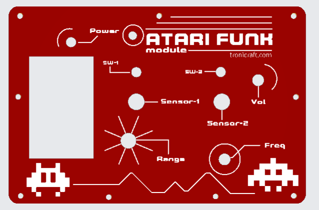

Thank you for reading. I've designed a control panel with EasyEDA, holes for pots and a cutout for an OLED. In the EasyEDA the 2D and 3D images show the correct cutout for the OLED, however after uploading to JLCPcb the images on their website show no cutout for OLED, only holes for pots.

Yes, you can make cutouts as seen in the image I posted above (the red control board). I've done it a few times, however for some reason when uploaded the design to jlcpcb the cutout area is not shown. After asking tech support they said it will be cut.
You can draw a square, rectangle or circle using the pink/purple board outline drawing tool. Or you can create a square/rectangle from the "pcb tools" menu, then right click the solid shape and choose " convert to board cutout".
I've done it both ways.
Only the red pcb shows the outline of a cutout, the blue board only shows a top silk layer of a square shape the I drew around the cutout.
When viewing the board with cutout in easyeda software using the 2D or 3D viewer, you will see the background grid, as if it the are was really cut out of the pcb.
The red board is what appeared in the 3D view of easyEDA software, the blue image of the board is what appeared in the jlcpcb website after uploading the gerber file.

So are you saying in the past they did show the cutout but now they don't?
Well, it seems like that. Here is a board I designed last year which shows the cutout in the image shown on the jlcpcb website;
Compare that with the board I just made and uploaded to jlcpcb;
*The blue pc board shows only the silkscreen outline that I drew around the area of where the cutout should be.
I don't really understand why, however tech support told me that the cutout on the blue board will be cut.
I see why you were concerned and I think it's bad prcatice on their part.
I still don't know if that difference was caused on my end or theirs. Maybe software?
