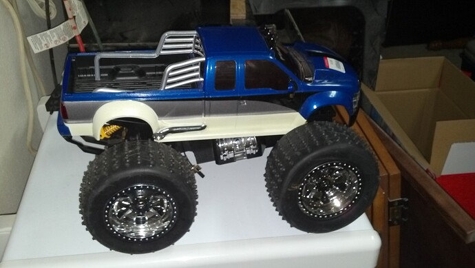

a found an old rc truck at goodwill for $5, pulled the guts out of it (except for the motor and rear axle), and mounted the servo up front for steering (it had a small dc motor/gear system). I bought a motor driver with PWM from sparkfun, and mounted/wired everything up on a radio shack PCB. After finding out that a single 9v couldnt power all three compontents (arduino, servo, motor), I ended up putting all three on their own power source. the arduino and servo both have a 9v going into a 7805 5v regulator, and the motor has 8 AA's. It still needs some work and a little rewiring, but i played with it out in the driveway today and it works pretty well. Next step is to shrink the Nunchuck contoller from using my Uno to a breadboard arduino with a battery 9(or just scrapping the nunchuck altogether and going with a joystick control, but for now, the nunchuck is kind of fun).

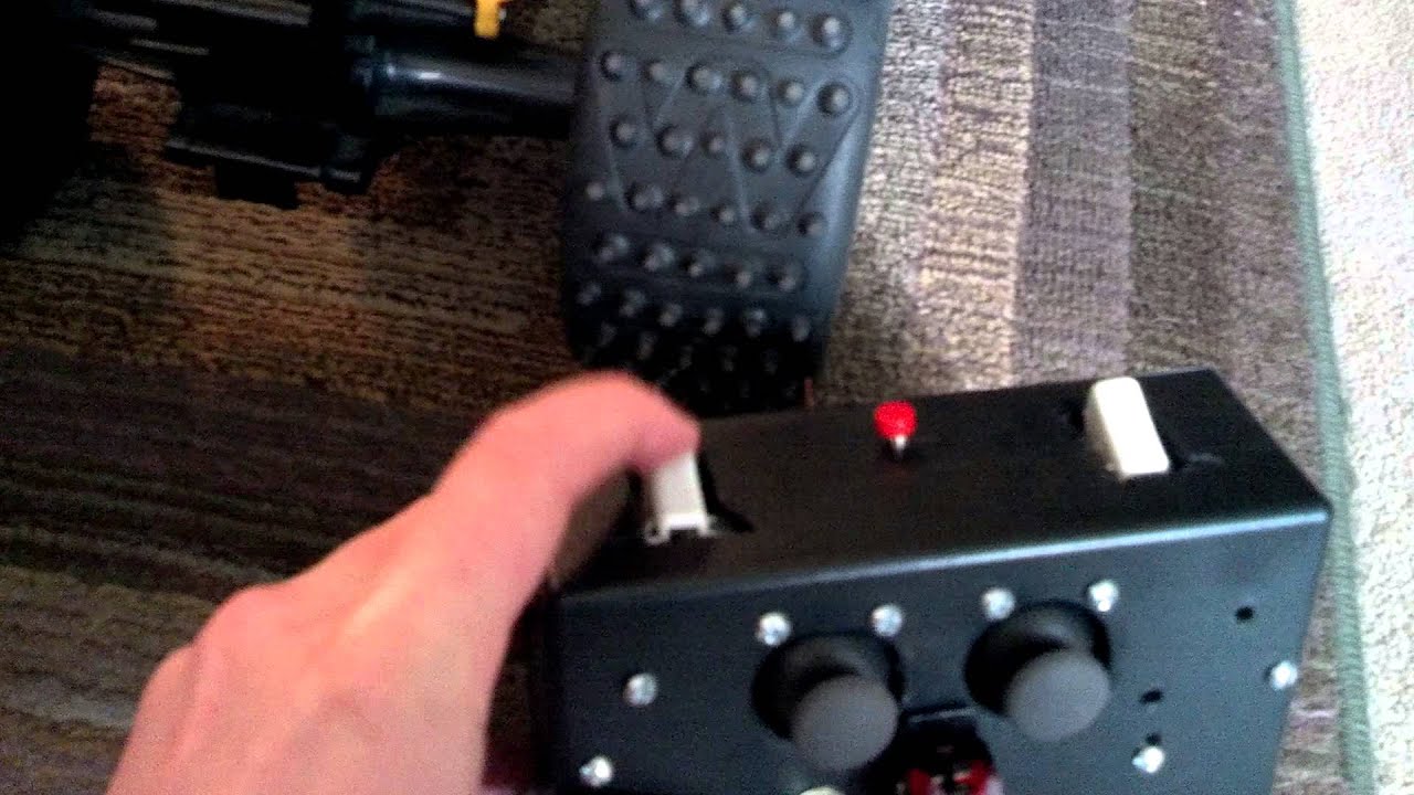

I decided to drop the Wii Nunchuck as I just got tired of it(and the accelerometer in it sucks), and my plans exceeded its capabilities. I went ahead and made my own custom controller, with joysticks and pot triggers. I plan on also adding in better accelerometer for the fun of it, but neither that nor the necessary multiplexer board have arrived yet (because everything requires analog inputs). I haven't finished everything on the inside yet, but here is a good look of the outside.
The red covered switch is the "fire switch" which will be enabled in the future when I hook up the pan and tilt laser targeting nerf gun.
So my controller is pretty much done. I had plans to include an accellerometer in it as well, but that plan is on hold for now. I have more to do with the body of the rc car that I want to get done first. Since the previous post, I added in a power switch and external reset button, as well as an external programming port (becouse i never want to open that thing up again). I upgraded the wiring on the body of the truck and finally secured the batteries in place. It currently runs on 8 AA's (motor), and a 9v (arduino, servo).
I finally got the accelerometer added in. I had to add in a multiplexer as i needed more analog inputs. For some reason the accelerometer readings kept changing based on whether it was plugged in or just running on batteries, so I gave it it's own set of batteries and it works fine now. all i have left is to finish up painting the body and get the missile launcher (foam) working and mounted. Source code included below.
