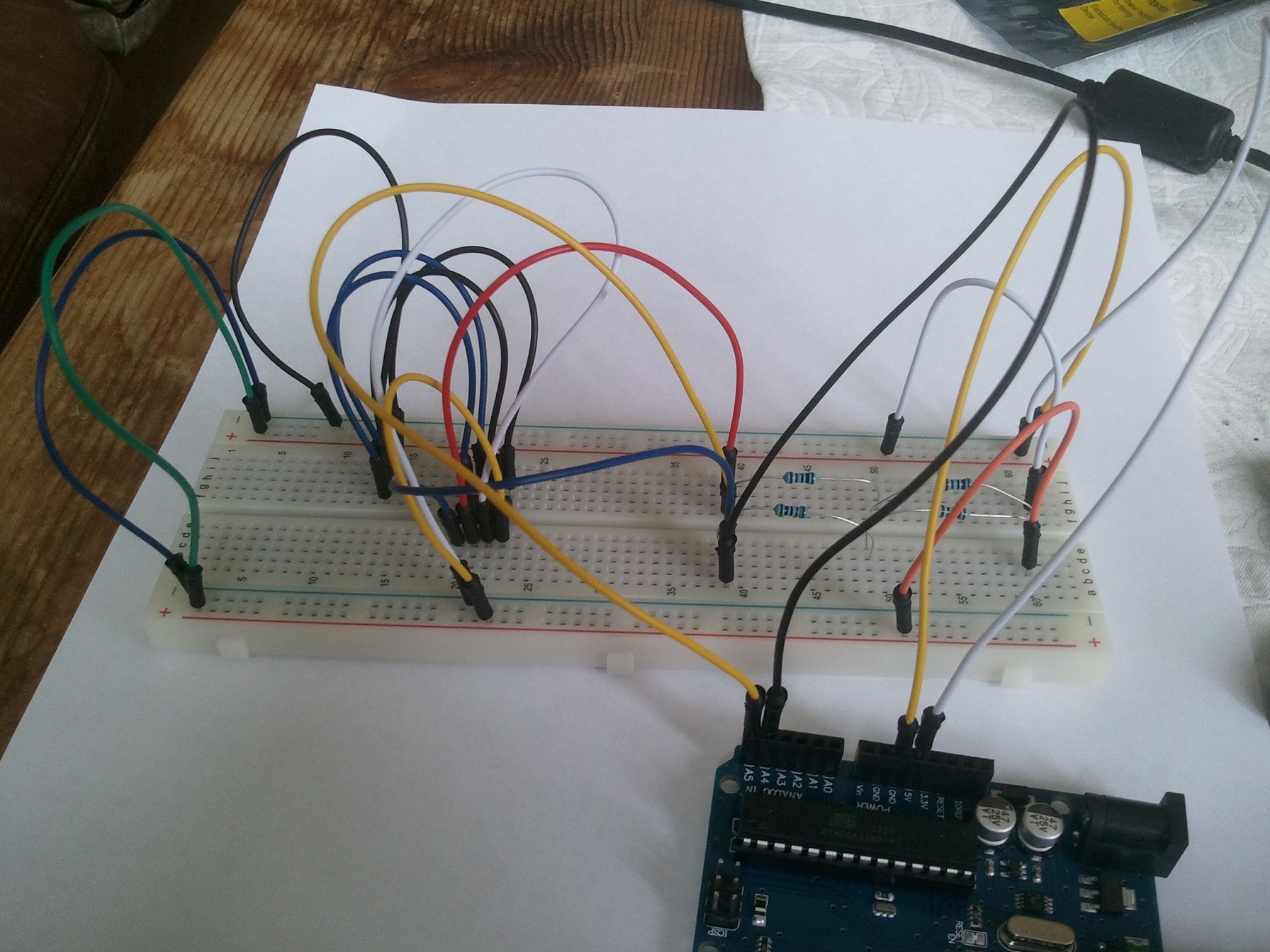

It's not likely to be a software issue, as I've run the i2c scanner on one of my projects just to see if I was going insane.

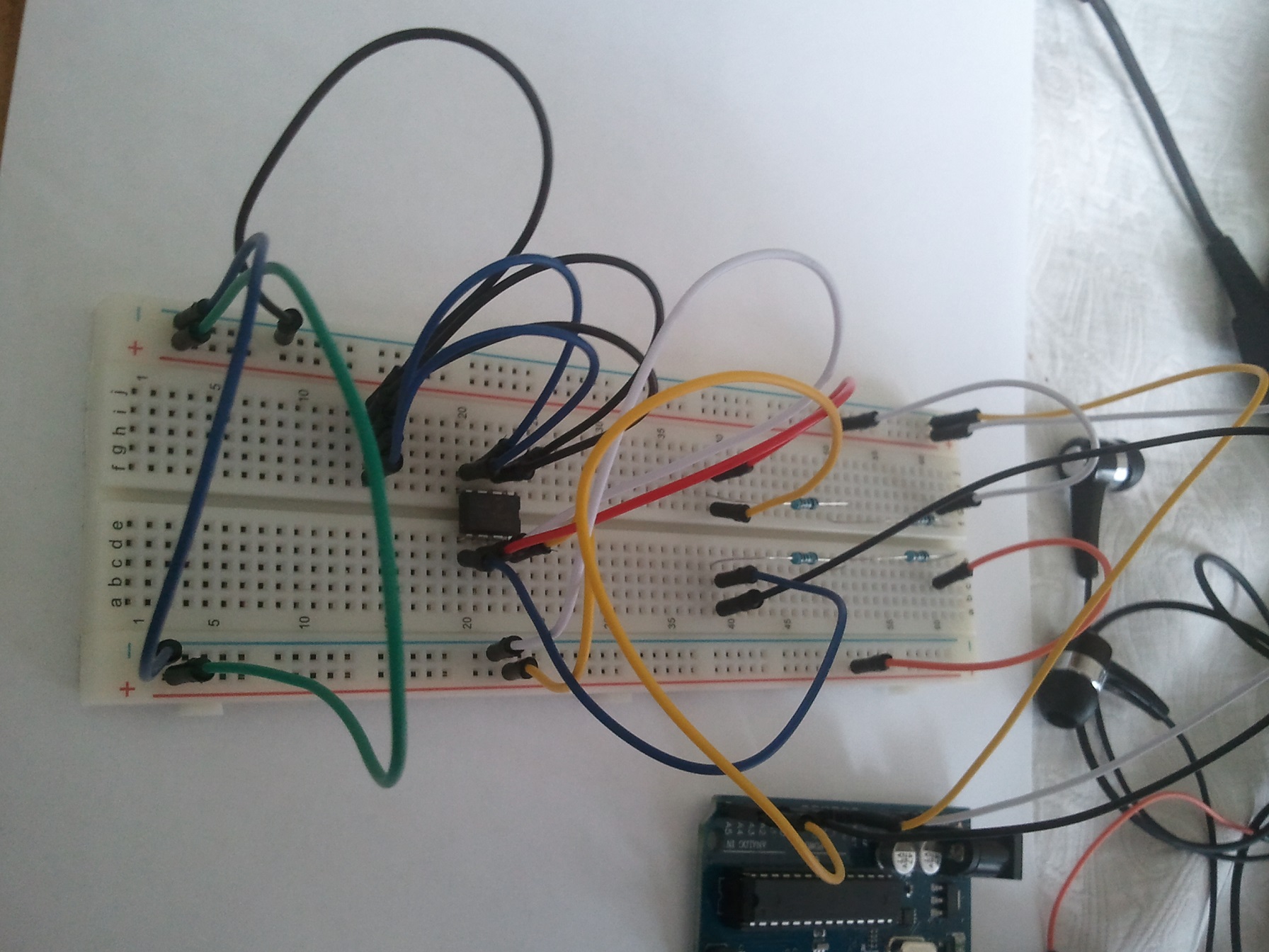

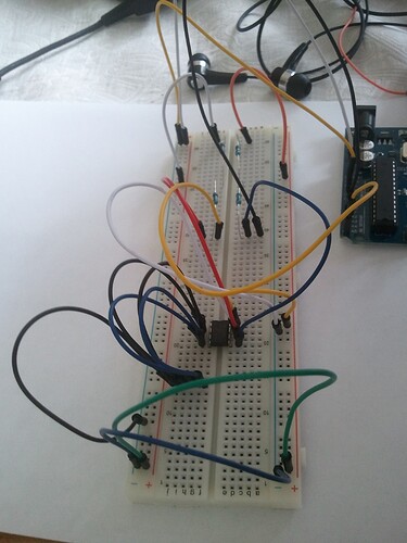

If you don't mind, take some pictures of your wiring, including breadboard. The LC series from microchip is a pretty robust chip, so I'd also have a hard time believing it's blown (though it is possible.)

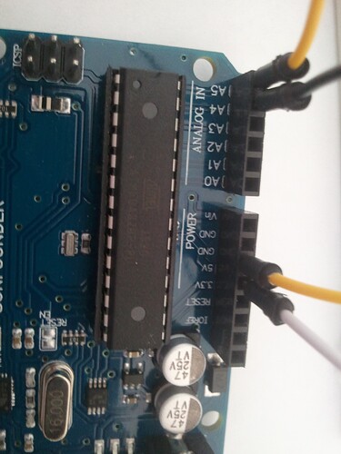

I attached a few pictures of my circuit from different angles.
I think i wired everything correct and i had a second eeprom so i replaced it with a new one, but still not working :frowning:
I have a rush repair on my bench and two engineering projects that just got approved, so I can't go in to too much detail looking at what's going on. We can continue this in PM, though.
That said, are you sure that breadboard's power rails carry right through? Have you measured that you actually get a resting 5 on both the SDA and SCL pins? In the interest of "because why not" have you tried swapping the SDA and SCL lines on the Ardy?

I tested a different I2C library with native scan function. It also didnt found a device, but when i removed the pull ups, the library scan function wrote "There is a problem with the bus, could not complete scan" so i think we can assume that the pull up part is assembled in the right way! Which als could confirm with my multimeter :wink:
The Power rails are also ok and carrying the right level..
Also the whole left side is set to ground and on the right side of the chip v and gnd are also right, i tested this with my multimeter.
I am a beginner it also can be a very stupid mistake of which no one has thought about yet :stuck_out_tongue:
The chip is also in the right direction, i checked the datasheet for it...
Swapping SDL and SCL also didnt help :frowning:
