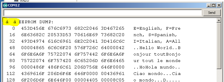

I am sometimes getting some strange characters from the USB/serial monitor after "upload".
It does not occur after reset or if I close the serial monitor and reopen it.
(please see the attached PNG file as I do not seem to be able to copy text from the monitor window)
I have tried adding delays, rearranging the variables, enlarging the buffer, Serial.flush() ....
Is there a way to 'clear' the outgoing serial buffer in setup ?
This is the code (and it does do a nice dump of the EEPROM). The device is a Nano.

I think that output is just spurious data picked up by the serial port while it is syncing to the clock.

"I think that output is just spurious data picked up by the serial port while it is syncing to the clock."
Probably ... now how does one eliminate it ?

  1. the problem occurs before execution gets to the loop in question
  2. if the loop continued past the end address then it would simply wrap around to the beginning and print the first line(s) again.
    (and yes I have tested that theory)
  3. if (the compiler can not generate proper object level code for a particular structure)
    {then that structure should be remove from the listed supported structures;}
    {it is likely to be used;}
  4. both versions randomly exhibit the same strange phenomena
