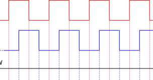

rotating at 1 Hz means 12500 pulses per second.
That is - If the pulse has a duty-cycle of 50% this means every 80 microseconds another pulse
On rotary-encoders the signals of the two channels have a shift of 90 degree to each other.
So the next pulse of the other channel can occur after 20 microseconds. To be sure over all this means
your ISR-executiontime has to be shorter than 20 microseconds.

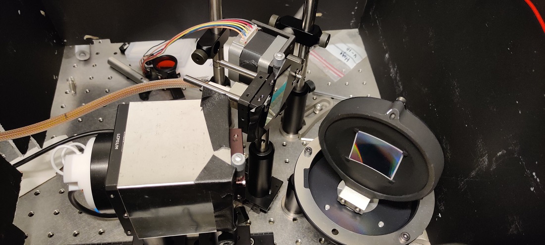

I am trying to build a cheap-but-highRes monochromator. I have a motor moving a holographic grating back and forth to split the color of a light source. The split colors illuminate a fine aperture (thus you get only one color output for each angle of the motor). The wavelength (or color) information at the output can be measured by knowing where the motor is at all times. For this reason I use a fancy encoder - the necessary resolution is very high.
Thus, I need to read the many pulses and be sure that I do not miss steps.
After a scanning of colors, I need the timestamps/positions in order to calculate the color at the output as a function of time/position.
Here is a pictures of a prototype because reasons!
Lorenzo
Thanks.. OPs picture;

Wow pretty high-tech-parts.
As you need such a high resolution to determine the exact position
what mechanical parts are moving? I took a close look at the picture but I don't understand how the parts move.
Whenever there is more than direct rotation of the stepper-motor I guess linearity deviation of the parts have to be examined too. For example even high-quality ballscrew-spindels do have a linearity deviation along the thread.

regarding the movement, I use a stepper motor with some fancy drivers to do microstepping to a high degree, making the motion very smooth. In the picture the motor is below the grating so not really visible. That is the only moving part.
Of course mechanics and linearity of movement play a huge role, but if the position sensing is precise enough, I can compensate once I get the data (doing some interpolation to obtain a wavelength axis with even spacing between points), so that is solved at least.

I'm not sure if understand the whole process right. By turning some parts with the steppermotor a lightbeam with a very small wavelength-band is created and I guess some light-sensor will be triggered if the wavelength is reflected or absorbed somewhere. With this triggering the wave-length can be calculated based on the rotating-angle.
So whenever the light-sensor is triggered a snapshot of the encoder-pulse-counter should be made.
So for each intensity-spike the pulse-counter-value is stored.
Is this a correct description of what is going on?
or is it that way
A lightsensor gives a higher or lower analog signal depending on the wavelength of the created monchrome light. Now the correlation between wave-length and sensor-signal is of interest.
This way storing the light-sensor-signal every delta-phi of angle is interesting.
This would mean the encoder-pulse increases the array-index and the array-element stores the light-sensor-signal.

To answer Stefan: a monochromator is basically a color filter. You have a white light on one side, which shines on a grating. This grating is just like the back of a CD, it splits colors in a rainbow. So if you rotate the grating you get different colors at the output. So a different point in the motion of the motor corresponds to a different color at the output, and I need to know exactly what color I have in every time unit.
This means high precision requirement for the position readout and also the need for a timestamp.
