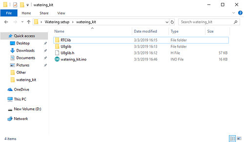

I got this recently as well and took me a bit to figure out how to get the script on to it as the preloaded one does not work correctly. not too sure if your question has been answered
the board is Arduino Leonardo (Tools->Get Board info once you plug it in and set it up)
after that set the board type and put it to the correct port I had to find mine in the device manager it should be listed as USB Serial Device (was for me) under Ports (COM & LPT)
The sample code link on Elecrow webpage is the one that I got mine to work on. in order to upload this script tho, you will need RTClib and U8glib libraries which you can manually download or include them va Sketch -> included library. and in the manager just search and install them
https://www.elecrow.com/download/watering_kit.zip
hopefully, this helps
