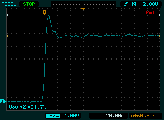

When you mention the "problem", are you saying that you already have an end result that shows the effects of the overshoot of the square wave or that you are just predicting that the overshoot will affect your end result?
Yes.
I want to generate a squared "sinusoidal" wave summing 4 weighted digital signals.
But,
every signal have overshoots so the results is a "dirty" sinusoid.
This is my problem, not a prediction.
My priority is to eliminate the overshoots from Arduino.
Maybe there is something wrong in my probe.
Thanks.

Only if it were that simple. Two causes for those spikes:
  1. gate capacitance: as long as you have mosfets, you have gate capacitance, especially when they are undampened;
  2. non-atomic operation on the output pins.
Essentially, you took the more difficult route when easier ones are available.

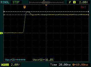

If i connect directly the probe to arduino i have this behaviuor:
A probe grounded with a spring have a better result:
So the problem IS the probe.
I the weekned i will post some results ...

I did the following modification in the schematic, so no more overshoots now. ]:smiley:
The resistor is 47 ohm, the capacitor is 10 nF
The current input of the switch is almost zero.
You don't need that capacitor - it is counter-productive, especially if you want to go to 1Mhz later.
You could have used some of the analog switches in the CD/HC family.
I would have used a 4.7 - 22ohm resistor to dampen, but not with an analog switch.
