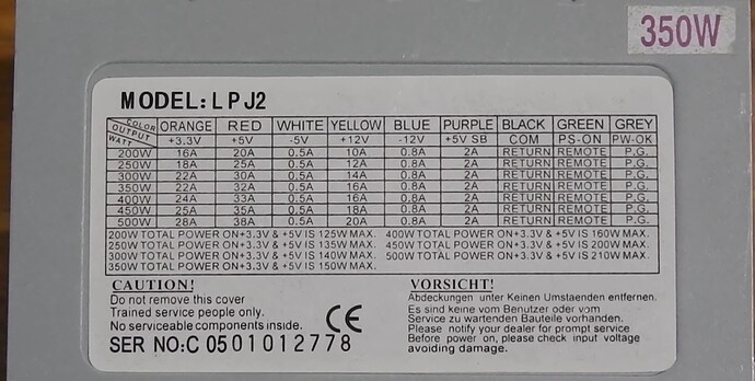

So I’m going to do one of these lab bench power supplies. I will have a output of 3.3V, 5V,12V. But the ampers are to high. Here a image of the specs.
So my question is how can i make match the energy from the power supply and what my components need( electromagnets: 12V,0.42A,5W/ LED: 5V / Arduino Uno :7-12V)
Hi, @eliobrunet
You don't have to match the current output.
Your circuit will only draw the amount of current it needs at the voltages stated, the specs are the maximum current you can draw from the supply.
So if your circuit draws less than the specified current then you will be okay.

Of course this is a huge mistake for this project. For the levitation you need to very precisely control the electromagnets to keep the levitating part balanced. Relays cannot switch quickly enough, MOSFET (or an IGBT) will be needed.
I would consider using a higher voltage power supply. Maybe 24 V? Or 19 V - common voltage for laptops so this can be relatively easily and cheaply obtainable.
Electromagnet is inductive and the current is proportional to its strength. You will need PWM control the electromagnets anyway and with higher supply voltage you can make changes in the current faster. You just need to make sure the duty is not too high for too long.
Oh. I didn't know it needed PWM (or any other modulating signal for that matter).
