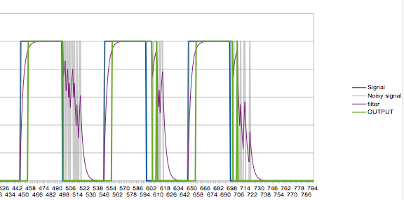

I'm currently looking at the behavior of this algorithm, as far as I can make it out.
presses within each group are separated by 100-300 ms, groups are separated by 300-1000 ms, and a pause of >1000 ms signifies the end of the current encoding batch.
So, let's take a sequence of 1,2,3 presses, each press being 200 ms (50 samples) and separated by 200ms (50 samples), the groups being separated by 400ms (100 samples).
To simulate noise of up to 100ms (25 samples), if the button is not pressed, then the signal will chosen randomly from the last 25 "real" button states.
|500x173

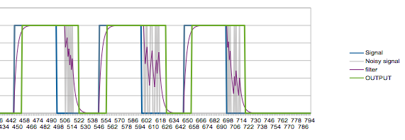

Now an obvious thing to see here is that if it is the case that the switch isn't bouncy when you press it down, only when you release it, then you can get a much better envelope with asymmetrical bounds on your schmitt trigger.
We can see in the graph that once the signal drops to .5, it won't rise to 15/16 again (a.k.a 0xf0). This gives us a tighter envelope.
|500x216

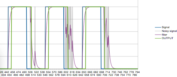

I raised that bound to .75 before I started seeing noise in the output
|500x247
As always, it all depends on exactly what is going on. If the bounciness is different to the bounciness simulated here, YMMV.

I’ll code it up tomorrow and see what the result looks like.
Ok, sorry about the rubbish posts - I see they have been deleted.
I have implemented this, with some tweaks, and uploaded a video to youtube. See post http://forum.arduino.cc/index.php?topic=339321 for the code.
The result manages to detect button clicks even when 25% of the samples are noise. Pretty good, I think.
