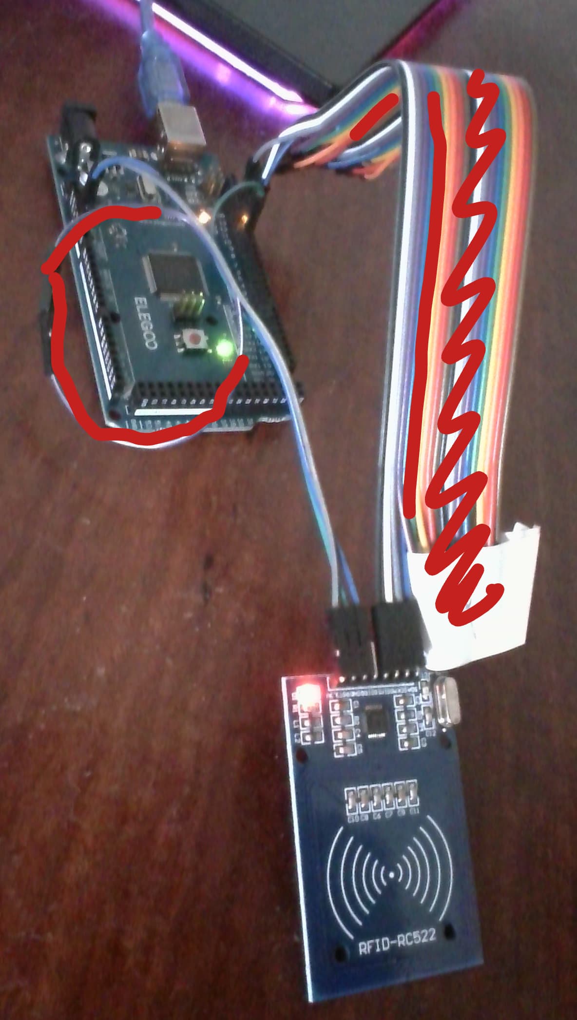

Hello,
I have an Rc522 with a card and a dongle from the brand ELEGOO and it won't read the cards. I have been using the dumpInfo code from the library Rc522 to try and get the card UID (for another project) but it says this in the serial monitor:
Firmware version: 0x0 = (unknown)
WARNING: Communication failure, is the MFRC522 even properly connected?

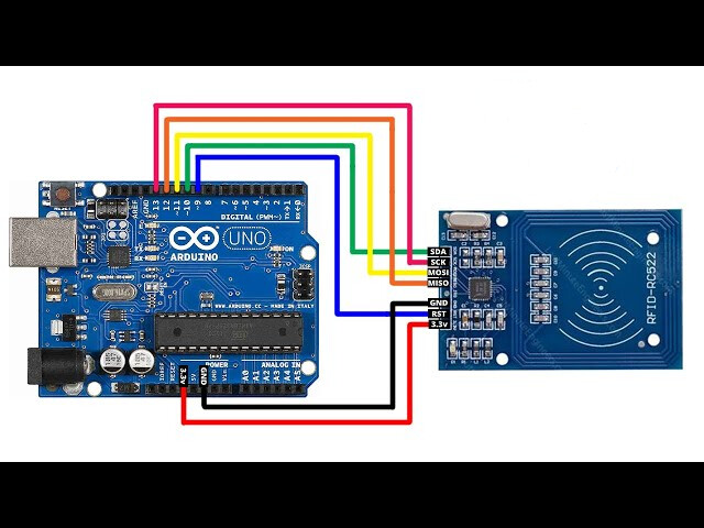

I have looked all over YouTube for tutorials but none of them work.
I have also redone the wiring loads of times but nothing changes : (
I would appreciate any help I can get.
Thanks
(red = spare wire) (ignore bad photo)
sddefault

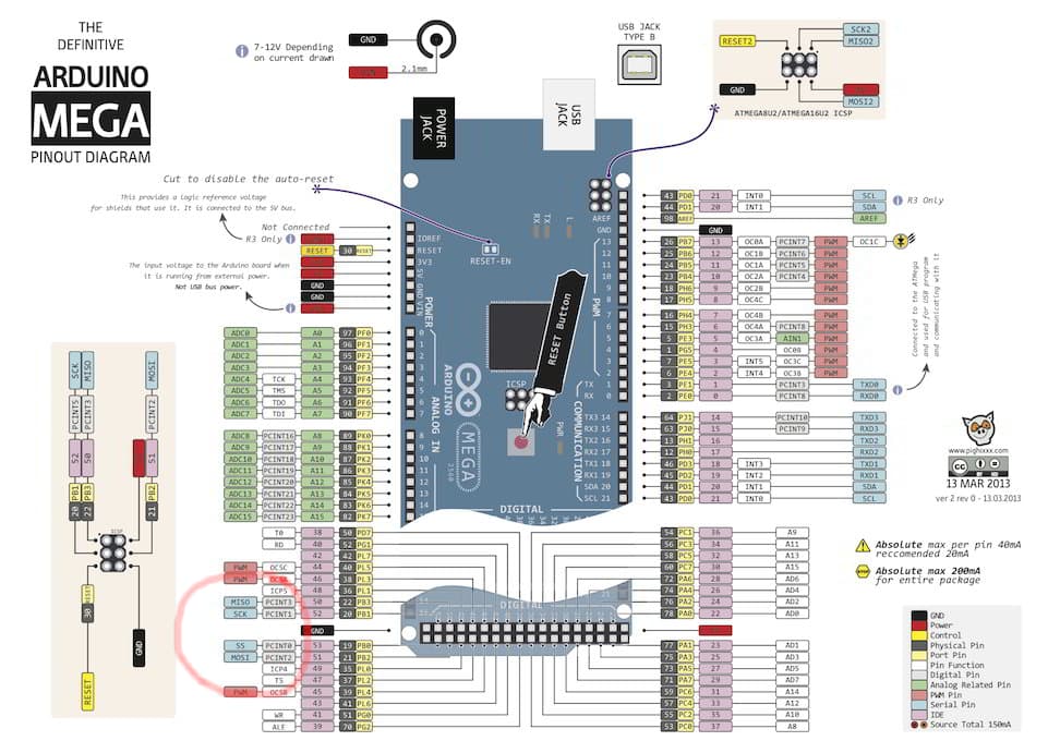

Your photo appears to show a Mega, not an Uno. The SPI pins on a Mega are not in the same place as they are on an Uno.
Also, I don't see any level shifters in your photo. The RC522 is not 5V tolerant, despite what you may have read on the web (but don't take my word for it, read the manufacturer's datasheet for yourself). It may tolerate 5V signals for a while if you're lucky, or it may already be cooked.
i have it plugged it into 3.3 volts on the board, but is isn't an aurduino board, it is from ELEGOO.
Very well then. Please disregard everything I just wrote. Carry on.
I am not sure if this is a problem by me, the code or the board itself.
We have had other reports that the RFID cards supplied in Elegoo kits do not work correctly.
I have a very poor impression of Elegoo myself due to all the complaints we get about them.
Are the RFID boards soldered in? You can't just push wires into them as some people have tried to do.
