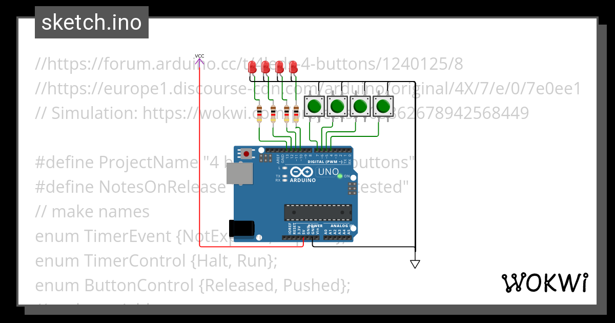

I see. Something like:
> [@4leds 4 buttons](https://forum.arduino.cc/t/4leds-4-buttons/1240125/8):
> Hello [shirogig](https://forum.arduino.cc/u/shirogig) Welcome to the world's best Arduino forum ever. Do you have experience with programming in CPP? My recommendation is to use a structured array. This structured array contains all information about the pins and a service to debounce the pins and a service to detect state changes. The results of the state change detection can be further processed for a blinking task. Consider: //https://forum.arduino.cc/t/4leds-4-buttons/1240125 //https://europe1.discourse-cdn.com/arduino/ori…
and
> **[4Led4Button\_Paulson - Wokwi ESP32, STM32, Arduino Simulator](https://wokwi.com/projects/405862678942568449)**
> Run IoT and embedded projects in your browser: ESP32, STM32, Arduino, Pi Pico, and more. No installation required!
A 10 floor, 2 car elevator with the normal set of lights and buttons is a lot of IO: at least 40 leds+40 buttons, and that's before touching doors and motors.
