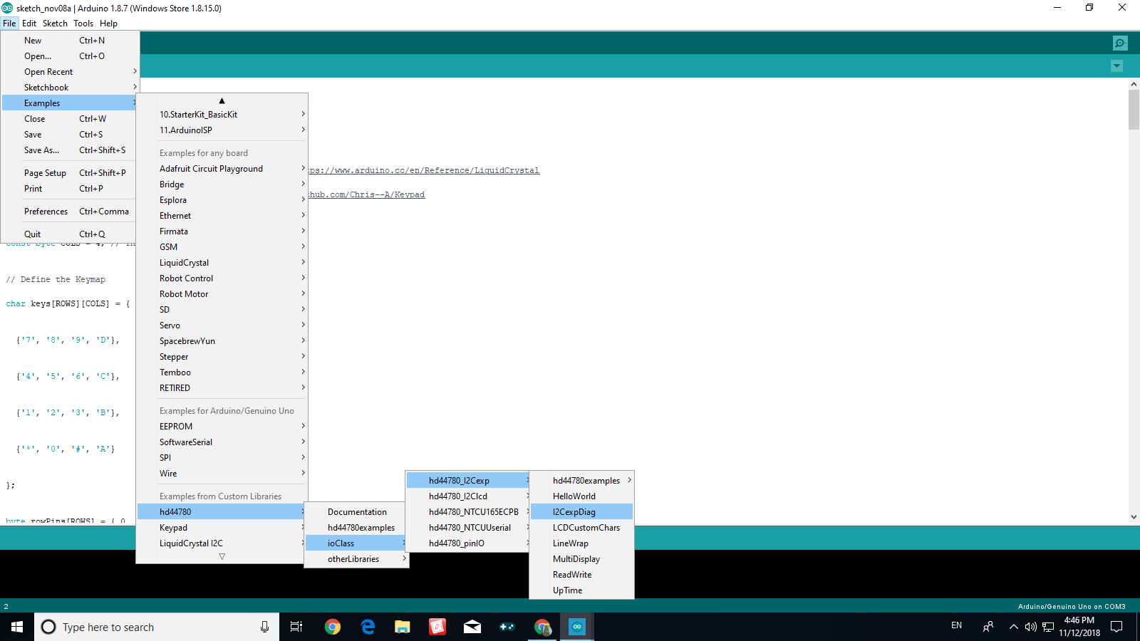

In the ioclass, hd44780I2C_exp examples of the hd44780 library there is a I2CexpDiag sketch. Load and run that example and copy and paste the output into a new post. That will give us an idea of what is going on.

Hey fungus Im not sure but is where im supposed to find it?
I have the 8 pins of the keypad connected to the first 8 pins on the arduino starting at 0>RX. I have the GND, VCC, SDA, SCl pins connected to female ports: GND, 5V, A4, A5 respectively.

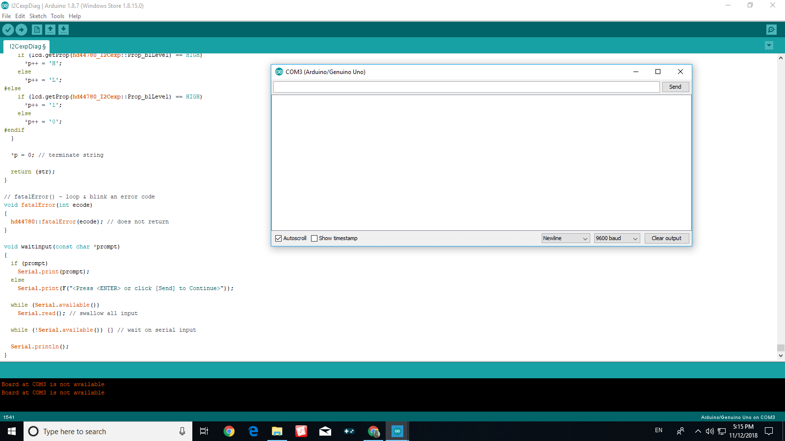

Yes, that is the sketch. Don't post a screenshot. Load the I2CexpDiag sketch and open the serial monitor. The sketch should run and then you can copy the sketch output text from serial monitor and paste the text into a reply, here.
Pins 0 and 1 are the hardware serial pins (USB). Using those pins for something else may interfere with program upload and serial communication. Can you use other pins?
I clicked on serial monitor under tools and this is what popped up.

I compiled the I2CexpDiag. Now im getting this LCD:0 (0x27) and a timer.
It also displayed this for a short amount of time:
That is good to hear. That means that the HD44780 library has found your display and it is working OK.
