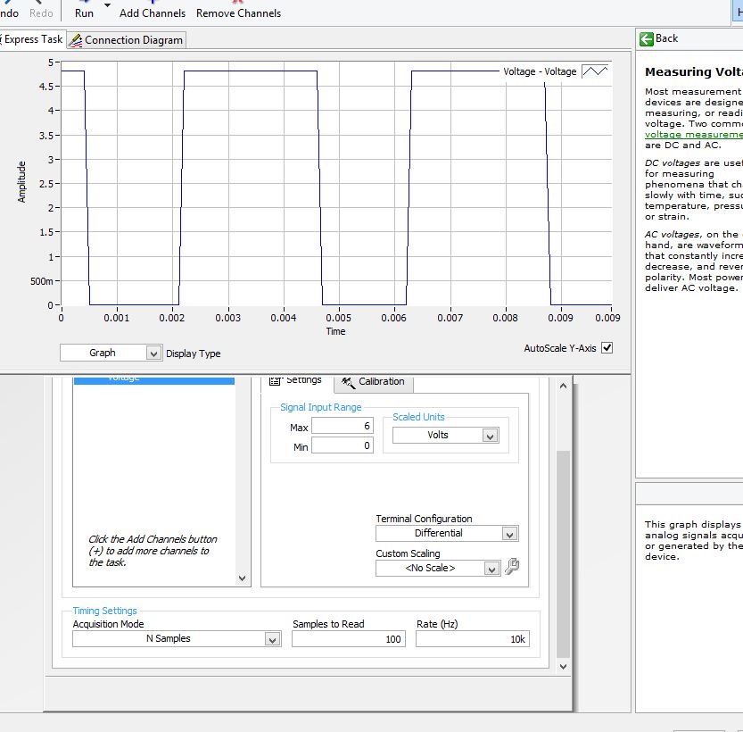

I bought this absolute encoder from ebay and it says it has a pwm output of 1kHz.
Encoder from ebay
I tried to collect some raw samples using labview and NI-6210 sampled at 10kHz, the results in attachment.
Now i'm new at this stuff so I need a second opinion but to me it looks like the pwm freq. is only about 250Hz as opposed to the 1kHz advertised.

Thanks for taking an interest.
The 250 Hz does matter since I want to update my controller at 500 Hz. I would not be able to do that if the duty cycle can be 4ms.
This is the model. XYK-BMJ-38Z6-P12
http://www.dhgate.com/product/xyk-bmj-38z6-p12-pwm-signal-out-put-absolute/213269801.html
I'm not an expert on PWM, but I assume the underlying PWM clock is 1kHz. If that's the case, with 12-bits (4096 counts) a PWM value of 1 would be high for 1ms and low for 4095ms.
I've used similar encoders before. You have a choice: do you want 12-bit precision or do you want 1kHz updates? You CANNOT have both with a 16MHz Arduino. You would need a much faster processor and a much more expensive encoder to get both.
500Hz is a good frequency to be updating a motor with current feedback but if you got position feedback at half that rate, that would usually be sufficient.
Well, seems like I could only do updates of less than 250Hz. Do you guys think 100Hz is enough for a inverted pendulum cart?
