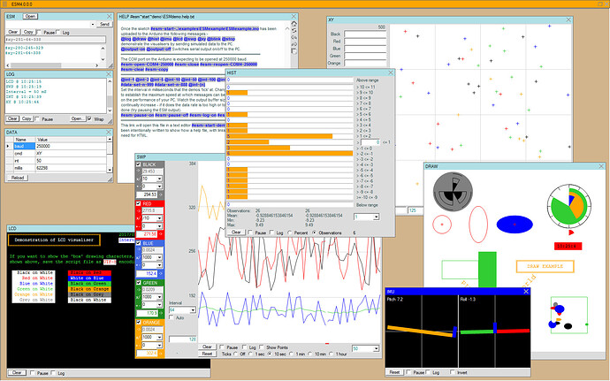

After a long incubation period I am releasing Enhanced Serial Monitor version 4 - ESM4.
This is a significant reworking of ESM3 with the user interface updated (the forms and visualisers make more efficient use of the screen space), message consistency is improved and less used features have been removed or retired. Messages to the ESM and Arduino are much easier now and the support library has been updated. The sample sketch includes sending messages to all the visualisers, using and updating the new database and controlling the ESM from the Arduino.
The changes include gain and offset for every channel in the sweep plotter. This means data that is significantly different in scale can be more easily observed. For example one channel with values around 0.01 and another with values around 100 could not be easily compared in ESM3 without adjusting the outputs in the sketch. Now this doesn't need to be done - don't know why I didn't do this a long time ago as it is one of the most useful visualisers there is. Also a tick marker allows you to make better observation of the passage of time as the plotting progresses. Auto-scaling is also much improved and it has a compact and wide option.
In fact, every form and visualiser has had some work done it.
However the biggest change is the introduction of scripting, a smart message aware help system and a simple database. Once extracted from the zip file to your PC (sorry not Mac) and the example sketch loaded, the features of ESM4 are accessible via the visualisers, as before, but also through the scripting and smart help. All of which is customisable to suit your own projects.
Furthermore it will shortly be available for download without having to ask for the link through email or private message. Due to the limited number of downloads it is quite likely your virus checker will get the ebeegeebees about it - sorry nothing I can do about that! Providing your Windows system is up to date it should simply run once it's on your hard drive.
It's free for personal use.
Here is a link to the old ESM3 thread https://forum.arduino.cc/index.php?topic=185740.0
And boy, does it look old now!
Also here is a screen grab of ESM4 showing all the forms and visualisers http://alanboother.co.uk/project-cafe/esm4/screengrab-01.jpg
|500x312

And this is what a smart help file, as seen on the screen dump, looks like:-
Once the sketch |#esm~start~..\examples\ESMexample\ESMexample.ino| has been uploaded to the Arduino the following messages:-
|@log| |@draw| |@hist| |@imu| |@lcd| |@swp| |@xy| |@blink| |@stop|

ESM version 4.0.2.0 is now available for download from http://alanboother.co.uk/project-cafe/esm4/_ESM4.0.2.0%7B97F83AC2%7D.zip
The big change in this release is the introduction of “Projects” and a few minor changes and a bug fix or two.
A Project in ESM terms is a regularised way to write sketches, scripts, help files and reset files. The ESM will write a complete running system, including the sketch file which will compile and run without modification. This makes it easy to get started, see how to use the features of the ESM. All these files can all be modified to suit your particular project. You don’t have to use the project approach and you can still just open up the ESM and use it as a smart serial monitor. Generated files come from templates which you can also modify to be more suitable to your own style.
The basic generated sketch shows how to communicate from ESM to Arduino and from Arduino to ESM, update DATA on the ESM and use it next time the Arduino sketch starts, switch the serial output on and off, automatically refresh data in the help screen which can also be used to update messages back to the Arduino…
The help files are a really convenient way to add in project support information either for end users or during development.
Each project now has its own independent DATA.
Smaller changes to the XY plot visualiser include support for the drawing commands found in the DRAW visualiser (LINE, PIE, TEXT etc) and a position cursor.
The SWP visualiser now records the data that appears in the view and may be replayed after you have adjusted the y axis scales and offsets. Useful in case you missed something important because you hadn’t set the axis to the best values before capturing the data.
The main help file has been rewritten.
The folder structure has been cleaned up and so it is recommended that a clean installation into the Arduino libraries folder is carried out and then any files you may have created copied back into it.
A really convenient tweak in this release is the automatic sending of messages indicating the COM port is opened or is closing. This allows you write your sketch to perform differently whether its connected to serial input/output or not – should that be important to you.
Cheers Alan

Hello Alan,
I have been using ESM v3 successfully for several years and just now decided to try upgrading to v4.0.3.0. I like the enhancements, especially the Project concept and the ability to put setup commands in the reset.txt file.
I wrote a simple sketch to try it out and observed a couple of issues.
-- In the reset.txt file, trying to set the Histogram interval (which I assume is the bin size) to 10, I was not able to get it to accept
hist~int~10
or any variation on that, including upper case and other values. It gives me the error
[ERR]#hist~int~10 [EX]Check message parametersIndex was outside the bounds of the array.
-- I see that you now have a mechanism with @PORTopened and @PORTclosing to tell the sketch to stop sending data if the port is closed. I noticed that if I do not use that and just close the port so the sketch is continuing to try to send data, the ESM hangs when I re-open the port. Perhaps a buffer overflows if there is a lot of data waiting when you open the port. I have to kill ESM in the Task Manager and restart it to recover.
I am using a 32u4 based Arduino with its integrated USB controller in case that matters. A simple way to get the sketch to stop sending serial data for these processors is to use the undocumented Serial.dtr(), which returns true if the serial port is open and false otherwise.
Thanks for all your efforts on this.
