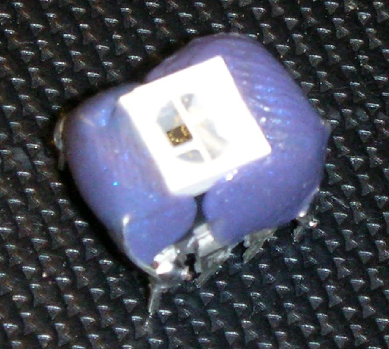

if it doesn't work, you could try the standard adafruit neopixel library instead... I know I've had that work on a tiny85... Here's a "programmable any-color LED" (neopixel piggybacked on an ATtiny chip...
 ![image](https://europe1.discourse-cdn.com/arduino/original/4X/0/4/3/043b24d33af68780c3513b81a6ba7fc1bb6c351f.jpeg)
