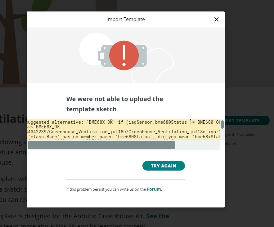

Error import ventilation template
Good morning!
I have a greenhouse kit.

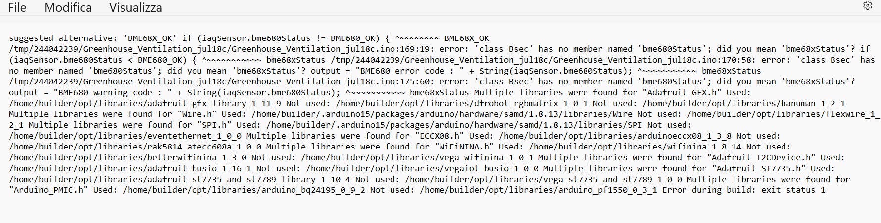

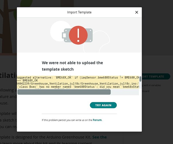

I have the following error when i import the ventilation template:
How can i do to overcome this error?
Thanks for all
Hi @mrsketch. I apologize for the problem importing the template.
The problem is that the template's sketch code was written for use with an older version of the "Arduino_MKRIoTCarrier" library. Unfortunately there was a change in the recent release of this library that made it incompatible with the template's sketch code.
The template developers are aware of the problem, but haven't updated the sketch code yet. So at this time an older version of the "Arduino_MKRIoTCarrier" library must be used with the template.
I'll provide instructions you can follow to configure Arduino Cloud to use the compatible version of the library:
  1. Click the following link to open the reference page for the "Arduino_MKRIoTCarrier" library in your web browser:
    https://www.arduino.cc/reference/en/libraries/arduino_mkriotcarrier/
  2. Click the "2.0.4" link under the "Releases" section of the page.
    A download of a ZIP file archive of that version of the library will start.
  3. If you are not already, log in to your Arduino account:
    https://login.arduino.cc/login
  4. Click the following link to open the Arduino Cloud home page:
    https://app.arduino.cc/
  5. Click the "CREATE NEW" button on the home page.
    A menu will open.
  6. Select "New sketch" from the menu.
    A new sketch will open in Arduino Cloud Editor.
  7. Click the icon that looks like shelved books ("Libraries") in the bar on the left side of the Cloud Editor page.
    The "Libraries" panel will open.
  8. Click the upward pointing arrow icon at the top of the "Libraries" panel.
    The "Open" dialog will open.
  9. Select the "ZIP" file of the library you downloaded at step (2) of these instructions in the dialog.
  10. Click the "Open" button.
    The "Open" dialog will close.
  11. You will now see an indicator at the top of the "Libraries" panel in place of the upward pointing arrow icon as the library is imported. Wait for this indicator to disappear.
Now try importing the template once again. Hopefully this time it will work as expected.
Please let me know if you have any questions or problems while following those instructions.
In case you are curious to understand why this workaround solves the problem, I'll provide an explanation below. If you aren't interested in the boring details, feel free to skip reading the rest of the post:
By default, Arduino Cloud uses the latest available version of each library when compiling a sketch. As I mentioned above, the latest version (2.1.0) of the Arduino_MKRIoTCarrier is not compatible with the template's sketch code. So we must force Arduino Cloud to instead use the compatible previous version (2.0.4).
Arduino Cloud gives preference to any libraries you imported to your account over the pre-installed libraries. So by importing the compatible version 2.0.4 of the library to your account, it causes Arduino Cloud to use that version when compiling the template instead of the incompatible version 2.1.0 of the library as it did before you imported version 2.0.4 to your account.
