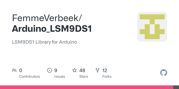

I am getting these errors:
error: 'class LSM9DS1Class' has no member named 'setAccelFS'
IMU.setAccelFS(3);
error: 'class LSM9DS1Class' has no member named 'setAccelODR'
IMU.setAccelODR(3);
error: 'class LSM9DS1Class' has no member named 'getAccelODR'
sampleEveryN = static_cast(roundf(IMU.getAccelODR() / kTargetHz));
I have the necessary libraries installed but still, I am not able to receive the output. Could you please suggest a way to solve the issue?

The library here
has the same name, but its contents are different (and it's 630k vs. 25k)
Your IMU functions --
  IMU.setAccelFS(3);
  IMU.setAccelODR(3);
  IMU.setContinuousMode()
are associated with it.
Uninstall your present library.
Install the library I referred to in the link ( ↑ ).
(If you cannot find it using Library Manager, copy& paste manually and re-start the IDE).
The "FemmeVerbeek" fork of the "Arduino_LSM9DS1" library is not available from the Arduino IDE Library Manager. The library of that name you will find in Library Manager is the original official library.
So you would need to do a manual installation of that library:
https://docs.arduino.cc/software/ide-v1/tutorials/installing-libraries#manual-installation
