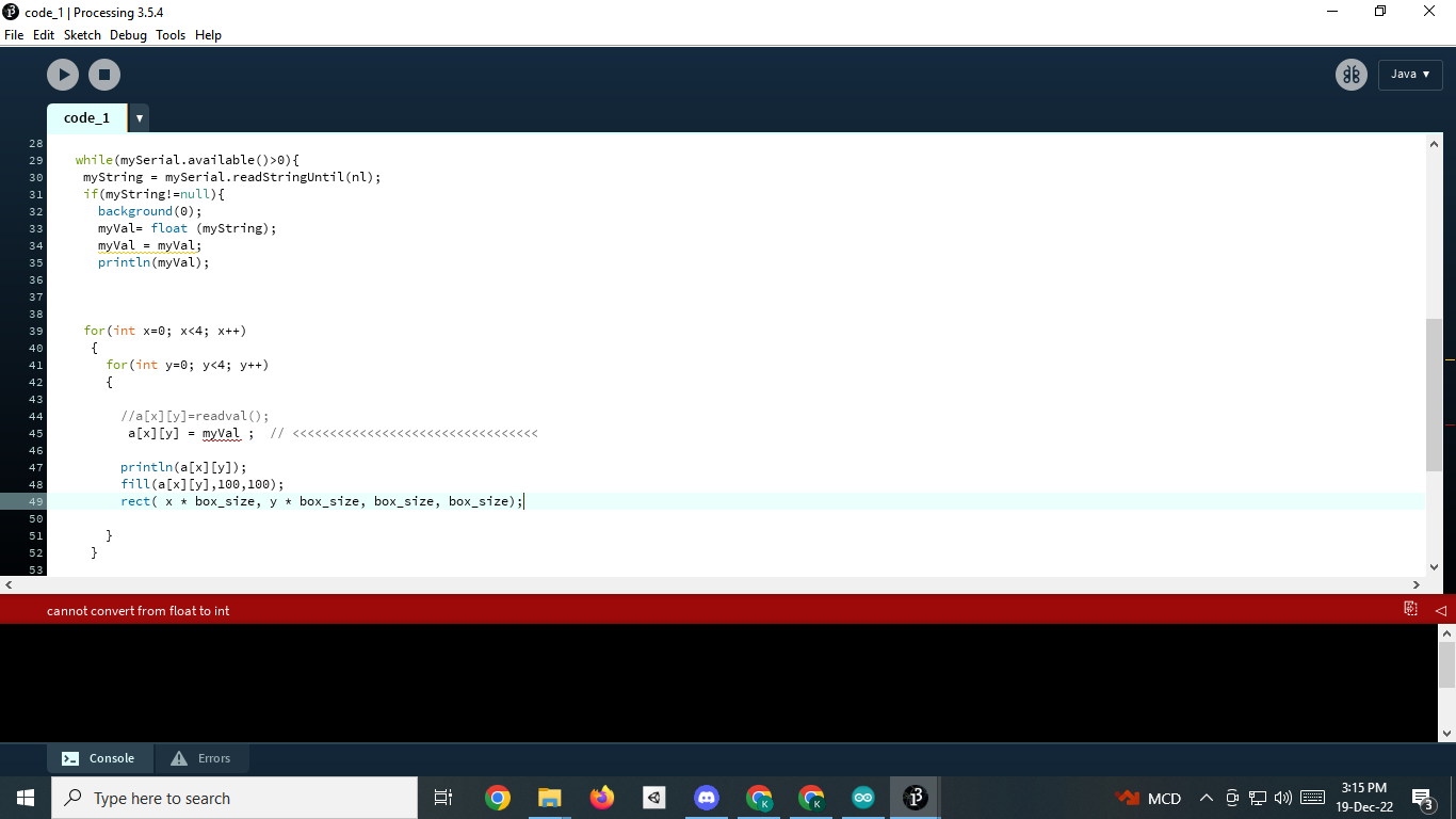

Then, if if have understood correctly what you are attempting, you add the line marked "<<<<<" below into your code.
for(int x=0; x<4; x++)
       for(int y=0; y<4; y++)
         //a[x][y]=readval();
         a[x][y] = myVal ;  // <<<<<<<<<<<<<<<<<<<<<<<<<<<<<<<<<
         println(a[x][y]);
         fill(a[x][y],100,100);
         rect( x * box_size, y * box_size, box_size, box_size);
it says it cannot be converted from float into int.
Try this line instead.
a[x][y] = myString.toInt( )  ;  // <<<<<<<<<<<<<<<<<<<<<<<<<<<<<<<<<
If that fails, show the exact error message and the exact previous error message you got where you said "it cannot be converted from float into int."

OK. I see. Processing seems then to need an explicit conversion. Try this:
a[x][y] = int( myVal ) ; // <<<<<<<<<<<<<<<<<<<<<<<<<<<<<<<<<

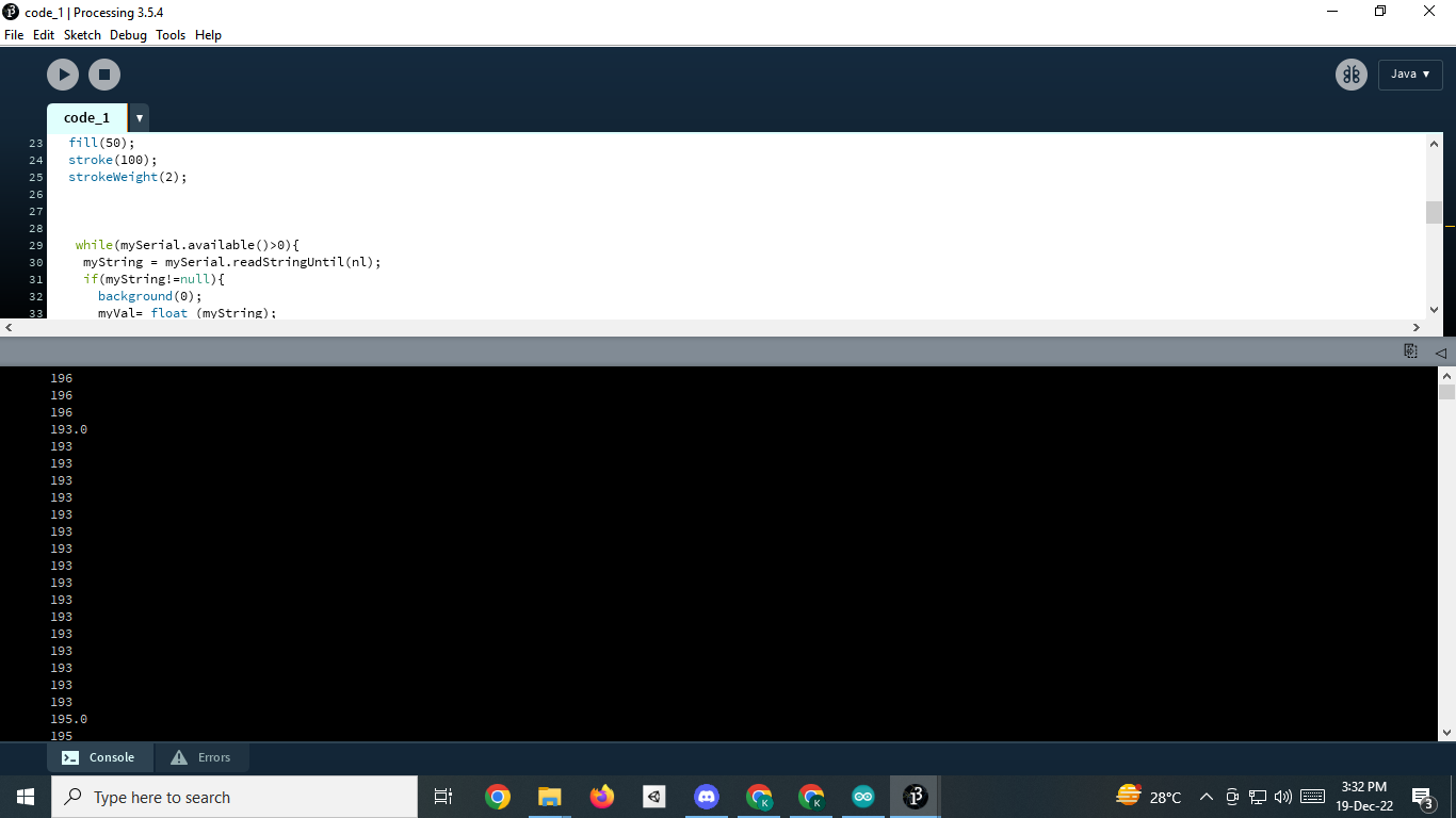

I guess we came almost..it worked but then same as 0 it is printing the same values again and again
I'm attaching the screenshot
notice he values they are getting repeated for 16 times..as mentioned in the array as 0 (16 times)
looking like this...values are repeating as per array declaration...
Well, how do you want the data, which comes from the Arduino, distributed in the array A ?
At the moment, each item of data is copied into all 16 array elements.

I'm sorry but your description is not enough to help.
You appear to be gettimg a large stream of analog values which come from an arduino. It looks like it could be delivering hundreds of values per second. You are reading these values in your processing code and appear to be putting these into an array. At the moment, you copy every data item into all 16 positions in the array.
You have mentioned that values are repeated but that is because, for each data item, you print it 16 times.
You have to give a more concrete description of what you are attempting to do.
