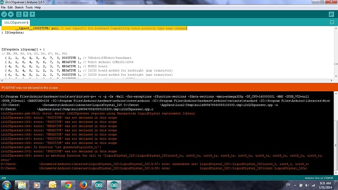

error: 'POSITIVE' was not declared in this scope
I turned on Verbose and the path is correct and I have removed all other LiquidCrystal folders.
Anything else I can try?

Here is a picture of the compile errors for the GUESSER program with verbose turned on.

paupline,
It is exactly as I suspected. You have not properly installed fm's library and are using the wrong library.
As I said before the only way to get that error is to be using the wrong library.
You can see in the verbose output from looking at the -I include paths,
that the sketch is using the LiquidCrystal_I2C library vs fm's library.
You cannot have multiple libraries that use a header file with the same name
because there is no way to guarantee which one is used.
In this case, the IDE has selected using the LiquidCrystal_I2C library vs fm's library.

Dang, I just noticed there are 2 locations for the libraries to be stored. I remove them both and it is now working.
