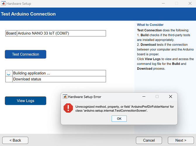

Hello 👋
I have recently purchased Enginering Kit v2
I am encountering an error while setting up my Arduino Nano 33 IoT with MATLAB. During the Test Connection step, I receive the following error:
 ![image](https://europe1.discourse-cdn.com/arduino/original/4X/7/d/8/7d82bf91cddeddc6edff6b906397273b9f4131b2.png)

Hi @voltvoyager1 and @venkat_ard. I don't have any experience with or access to the Arduino Engineering Kit, but I did find another report of someone who encountered this "Unrecognized method, property, or field 'ArduinoPrefDirFolderName' for class 'arduino.setup.internal.TestConectionScreen'" error:
> **[Problem with Simulink support package for arduino](https://www.mathworks.com/matlabcentral/answers/2123566-problem-with-simulink-support-package-for-arduino)**
> All of a sudden, my installation of Matlab R2024a is not working with the Arduino support packages in simulink. I tried reinstalling MATLAB and the support packages themselves, but am getting the ...
It was suggested there that the solution is to use version 2023b of MATLAB instead of the latest version 2024a.
Give that a try and let us know if you still have the problem after that.

Please go to the [matlab/download](https://www.mathworks.com/downloads/)
select R2023b and install.
