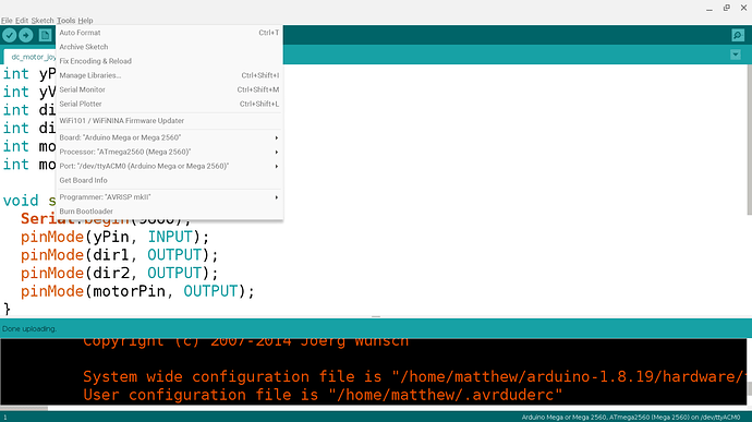

The project I'm doing is controlling a dc motor with a joystick. It worked this morning but no matter how many times I shut down / restart my chromebook it doesn't run. My Chromebook runs on chrome os and there is a Linux upgrade available but I haven't done it because I don't think it affects the project (the upgrade has been available for weeks).

Hi @matthewgri. Please add a reply here on this forum thread to tell us which Arduino board you are using.
Please be as specific as possible as some Arduino boards with similar names have significant differences and the forum helpers can only provide effective assistance if we are aware of which one is being used.
If you aren't sure how to describe which board you are using, you can provide the link to the online product listing you bought the board from and we'll proceed based on the information found there.
It had said on the first line of code, ATmega2560
That only tells me which board you have selected in Arduino IDE. It doesn't tell me which hardware you actually have. One of the common causes of this error is having a different board selected in Arduino IDE than the hardware you are attempting to upload to.
Going forward, please just answer the questions and drop the attitude. This will go much more quickly and be more pleasant for both of us if you do that.
So even though you didn't really answer the question, I'll proceed on the assumption that you actually do have an Arduino Mega 2560 board.
I'm going to ask you to provide the full verbose output from an upload attempt.

That is the non-verbose output. I need the verbose output:

Select Tools > Processor > ATmega2560 (Mega 2560) from the Arduino IDE menus and then try uploading again. Hopefully this time it will be successful.
Thank you!

Problem happened again...
here's the error code:
Arduino: 1.8.19 (Linux), Board: "Arduino Mega or Mega 2560, ATmega2560 (Mega 2560)"

@matthewgri
You still didn't enable a verbose output in the Arduino IDE as you were asked in post #7
@b707 the upload box I thought was checked, I did it again just to be sure. Here the code is:

@matthewgri
Below is part of the output that you cited in your last message:
The text proves that at least one of verbose output checkbox still not checked.
@b707, @ptillisch had asked me to check the upload box not the compilation. I believe it's a problem with uploading, not compilation but here are the error code messages for compilation and uploading process:

I see, thanks.
Could you show a screenshot of the IDE menu with board settings?
@b707 here -
