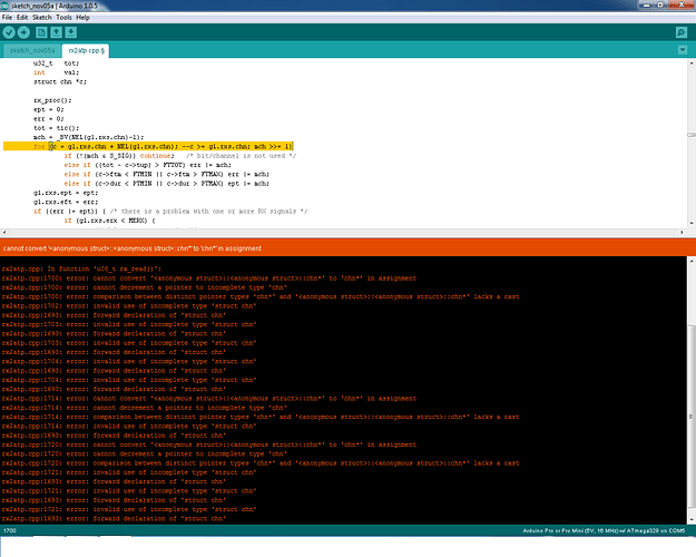

Hi all, i encountered this error code from the picture below when i verify my code for ultrasonic sensor & Mirumod rx2atp(for Ar.Drone) and is unsure how to solve it. Any helpful comments will be appreciated! :slight_smile:

Looking at the r2xatp source, it appears to be designed to be built and loaded on the Arduino without the Arduino core. For example, it contains its own definition of function main(). Maybe this worked when using Arduino 0022/0023 (which is what the web page says it has been tested with), but not with Arduino 1.0 and later.

core.a(wiring.c.o): In function `init':
/Applications/Arduino_1.0.5.app/Contents/Resources/Java/hardware/arduino/cores/arduino/wiring.c:193: multiple definition of `init'
rx2atp.c.o:rx2atp.c:2860: first defined here
void init(void)
Well, init is defined twice. There is an init in wiring.c and you have your own one.

You have your own main as well. You can't have two mains.
I'm not sure what you are trying to do. You can't bang two lots of code together in two different files and hope for the best.

Any solutions to the error code below? I've tried char foo; & #include <SoftwareSerial.h> but both doesn't seemed to be the solution :~
Does the file have #include "Arduino.h" at the start?
@dc42 nope, the error still exist even when i add that line in.. :disappointed_relieved:
Perhaps you need to rename the .c file to .cpp.
@PaulS i think it solved the problem after renaming but any idea how is this code for (c = gl.rxs.chn + NEL(gl.rxs.chn); --c >= gl.rxs.chn; mch >>= 1) related to the error below? :confused:
