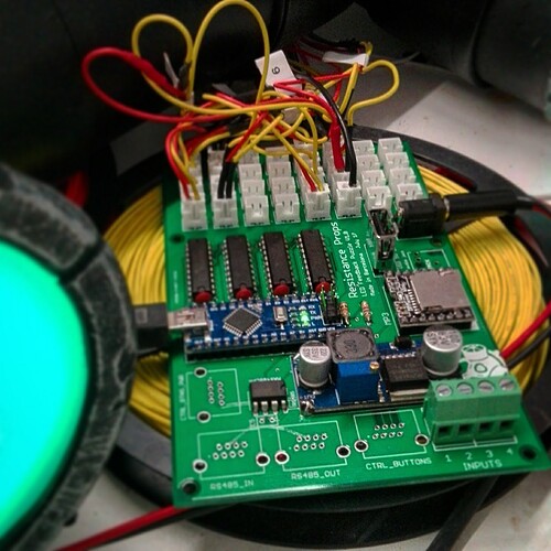

I'm working on an Escape Room puzzle and I got stuck pretty hard. I've been searching for a few hours and didn't find anything helpful so I thought maybe someone can point me in the right direction.
I'm relatively new to arduino (a year or so) and I've learnt a lot from the forum so, thanks!
The part I'm working on right now is supposed to receive 4 inputs from other arduinos in the room (single wire that turns High when another puzzle is solved) and then turn on a few lights (12v LED strips) depending on how many inputs are high.

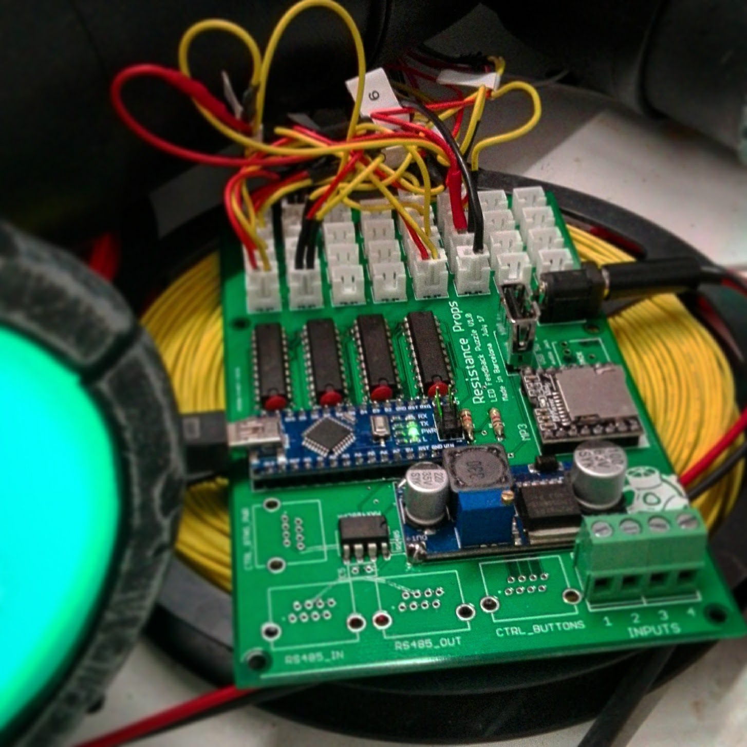

I'm using an arduino nano, 4 TPIC6b595 shift registers to control the 12v LEDs and a dfplayer module to play sounds. Everything is powered with a 12v power source and I have an LM2596 step down module that lowers the 12v to 5v to power the arduino and the DFPlayer.
Everything is soldered to a custom made pcb. There is also a rs485 chip and a few connectors there, I'm not currently using them but I put them there trying to plan ahead so in the near future I can control the arduinos from another room.
You can find the schematic attached.(semafor.pdf)
I started coding the part that has to do with the TPIC's. It is done and works well, all the lights turn on and off when they should.
But when I was going to add the code for the dfplayer I found out the shift registers stoped working.
I started commenting out parts of the code and I found out the one messing it up is the SoftwareSerial. If I comment out the line where I create a new instance of the SoftwareSerial it works.
This is the line that makes the shift register stop working:
SoftwareSerial mySoftwareSerial(8, 12); // RX, TX
You can find attached the schematic and here goes the full code: (it is not finished, it's just there to test everything works as expected, the "for" in the loop won't be there in production)

Is there any way for me to use the dfplayer at the same time as the shift registers?
Thanks a lot!
Sorry if my english is not good enough, if something is not clear, please ask and I'll try to explain that part better.
