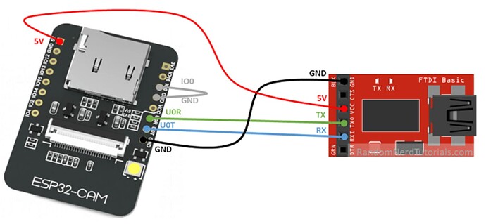

I want to program a esp_32 cam board and it tries to connect but says "A fatal error occurred: Failed to connect to ESP32: Timed out waiting for packet header
". What am I doing wrong? When ...... appears, I also push reset. Connection still fails. I also have problems to connect with a flashing programm to upload bin files, probably the is a connection between these problems.
You have to connect IO pin 0 to GND, and then press RESET. This will put the ESP32 into programming mode and you can then upload a sketch.
I have already tried it, like you showed me. It seemed like connections were not working. I used an Arduino as a programmer and this worked.
