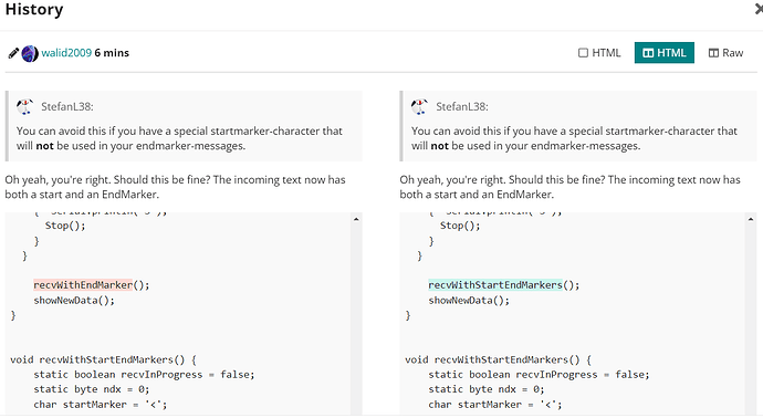

Oh yeah, you're right. Should this be fine? The incoming text now has both a start and an EndMarker.

you should do a compile-test before posting code
trying to be quick is slowing things down.
I've done it, it doesn't give me any error
when I was copying the code that you have posted there was this
    recvWithEndMarker();
    showNewData();
void recvWithStartEndMarkers() {
and this does not compile for very obvious reasons
As you can see in the history of your post you have edited it
You did not change anything else in your code which means the former described problem still exists.

You have to find a way that both messages are received securely.
The messages without the start/end-marker
and
the messages with start/endmarker
The function recvWithStartEndMarkers() starts to readout from the buffer
only in case it comes across the start-marker flag receiveInProgress is set true
        else if (rc == startMarker) {
            recvInProgress = true;
this means if there are bytes in the receive-buffer that are not the startmarker the bytes get thrown away and are lost forever
if you send a non-start/endmarker command and your code is below
   if (SerialBT.available()) {
   receivedCharForMoving =(char)SerialBT.read();
    Serial.println(receivedCharForMoving);
the command will not be executed
the other way round if the startmarker of a start/end-marker-message is picked up at this line of code
the below call of
    recvWithStartEndMarkers();
does not see the start-marker and will throw away the hole message
because of
    while (SerialBT.available() > 0 && newData == false) {
   receivedCharForMoving =(char)SerialBT.peek();
    if(receivedCharForMoving == 'F')
    {   Serial.println("F");
      Forward();
    if(receivedCharForMoving == 'B')
    {    Serial.println("B");
      Backward();
     if(receivedCharForMoving == 'L')
    {   Serial.println("L");
      Left();
    if(receivedCharForMoving == 'R')
    {   Serial.println("R");
      Right();
    if(receivedCharForMoving == 'S')
    {  Serial.println("S");
      Stop();
    showNewData();
        rc = SerialBT.read();
        if (recvInProgress == true) {
            if (rc != endMarker) {
                receivedChars[ndx] = rc;
                ndx++;
                if (ndx >= numChars) {
                    ndx = numChars - 1;
            else {
                receivedChars[ndx] = '\0'; // terminate the string
                recvInProgress = false;
                ndx = 0;
                newData = true;
void showNewData() {

the moving commands must have a start-character so you can detect it is a moving-command
you should do this by using peek() because if this first character is not the start-charcter of amoving-command
then
it is the start-character of the chatGPT-answer that starts with a different start-character
The chatGPT-answer starts with a start-character and this this start-character is needed to make the start-end-character -receive-function work
Without the chatGPT-text-start-character the whole rest of this chatGPT-text will be thrown away
vanish, will be deleted, no longer accessable.
do you understand?
