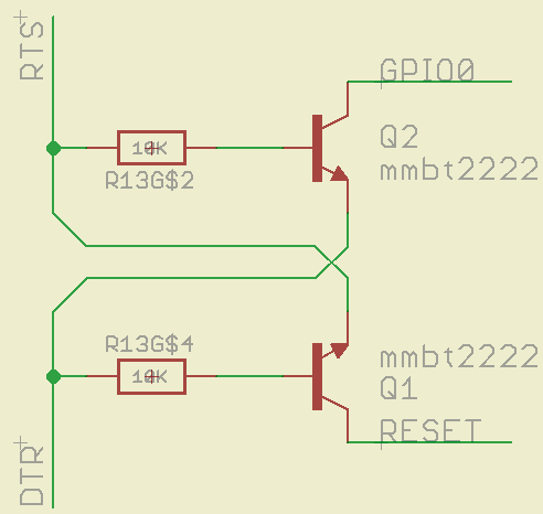

I am flashing a custom board , and it gives this error attached in picture....
I have another custom board which works properly with same schematic.
One thing i observer, boards ordered for one project which works for me are flashing directly without any issue.
But in this lot i face issue as shown in picture. I am attatching picture flashed through ESP IDF and Arduino both. Please help

Try disconnecting the circuit attached to pin #3/EN. Remove r8 as well. Disconnect anything else that may be connected to these pins.
The circuit around Q2 and Q3 looks like the auto-reset feature that allows Arduino programming, but it's implemented wrong. You probably mean this:
The pin labeled RESET in the pic above is called EN on your ESP32.
This page is convenient in deciding which pins to use for your project: ESP32 Pinout Reference: Which GPIO pins should you use? | Random Nerd Tutorials
Be wary of using any pins that *don't * have two "OK's" listed for them.
