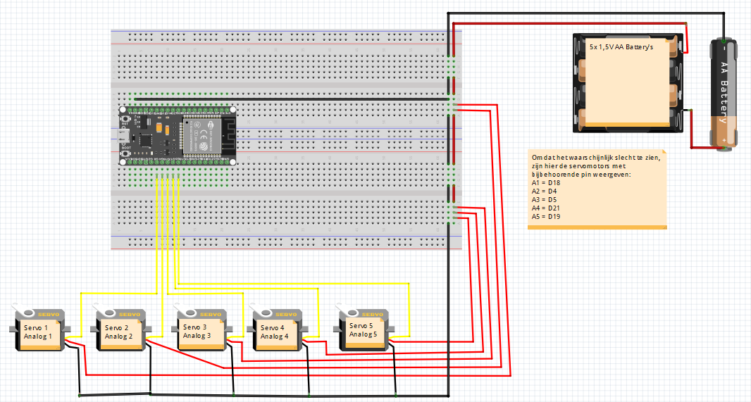

ESP 32-(NOW)- Flexsensor and servo motor
For a project we are trying to use an ESP32 with flex sensors, to control the servo motors attached to another ESP32 (connected via ESP NOW). The transmission sequence works and the data gets received, however the servo motors do nothing. We used the codes and library below, any hints on why it isn't working would be much appreciated.

What does "didn't work" mean? Do your Serial.prints show that the correct data is being received? If so quite a lot of it did work.
What servos are you using. How exactly are they connected and powered? Many/most servo problems we see turn out to be power or connection problems. Have you tried it with just one servo connected?

When you make big code updates means the code originally posted is useless, so update your code in your postings. Could you post the magic code you used to test the servos by themselves?
How are you supplying power to the servos?
Are the servos connected to a breadboard?
Besides 'it does not work' which is not very helpful, what does it does not work mean?
Are you powering the servos with a 9V battery?
Here's the current code I'm using to test a single motor, there's also a schematic posted underneath the code on the current total setup of the motors. They are receiving power from multiple 1.5V batteries instead of a 9V

I tried but, it is obvious you'll not follow instructions or answer questions. Good luck.
How many is "multiple" AA batteries? Your hopeless picture seems to have 5 plus another one making 6.
And I'll ask once more...WHAT SERVOS ARE YOU USING? There are very few servos that can tolerate 9V.
Also servos use more current than can safely be carried by a breadboard so that's another likely failure point.
Steve
