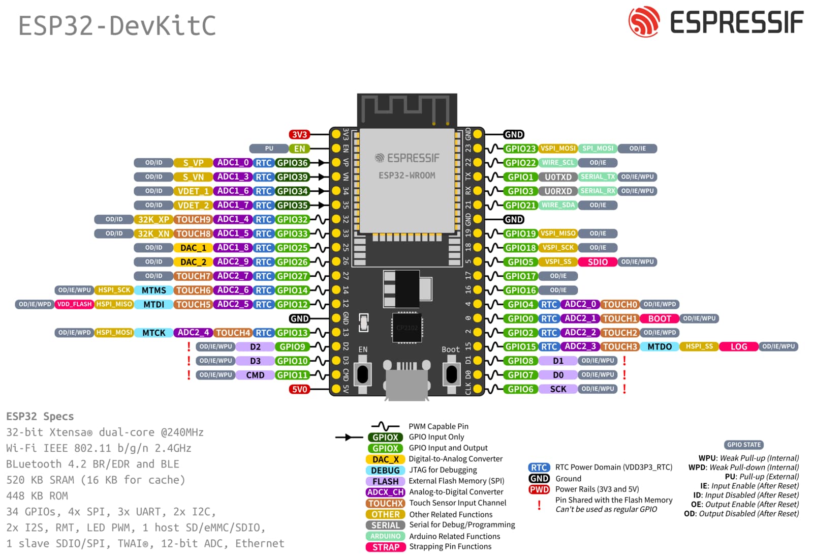

Actually with less number of pins on WROOM model 38-pin
I am trying to increase number of inputs as much as possible using touch or analog INs, whatever
I just designed this one with 2 analog inputs with
resistor 680k which shows range of 2000 to 2300 and
resistor 470k which shows range of 2400 to 2600 approx

From memory, there are only 6 pins on the ESP32 that allow you to use the touchRead() function. If you want more touch input pads then you will need to use a different method such as analogRead() and a resistor ladder.
Be aware, however, that will quite probably not be reliable unless you use an external device, maybe the TTP223, on each pin. The ESP32 touch pins do not need any extra circuitry because they work differently
Yeah with Wroom model 38 pin it has 10 touch pins as per diagram below
And I observed it practically one by one on trainer board
Though it is 10 but of no use as this one is engaging approx all the pins for further use like sensors or display devices and etc etc things !!!
Too I need 16 or 20 or may be more than 20 inputs here so a ladder pattern is all the way good !!!
