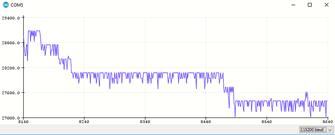

I am using Arduino's IDE to compile a simple code for the integrated wifi on the ESP.
The problem is that, after several iterations, memory drops down (is that the exact verb?)
I show you a memory-time graphic.
Code is very simple.

Do you have any suggestion?
This esp is supposed to work 24/7 for years.
Thank you very much
Try to get rid of String object, use a char buffer instead, it should help.
Ciao, Ale.
I think somehow payload isn't getting freed... couldn't say why though.
