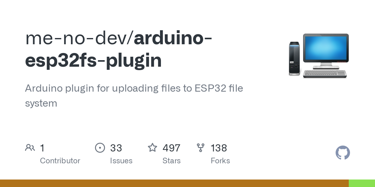

Hi @jimmym21.
Is this the one you are attempting to use?
Yes, It's the only one I know of.
I just tried installing it in Arduino IDE 1.8.19 and it worked fine.
In my experience, this type of problem always ends up to be caused by incorrect installation of the plugin.
