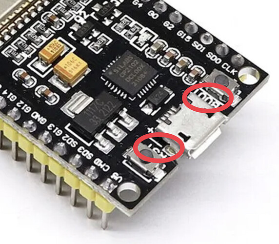

**Author:** ![anon85221860](https://avatars.discourse-cdn.com/v4/letter/a/59ef9b/32.png) [@anon85221860](https://forum.arduino.cc/u/anon85221860)\
**Post date:** [April 29, 2023, 6:20pm UTC](https://forum.arduino.cc/t/esp-wroom-32-not-connecting-to-pc/1119605/31 "2023-04-29T18:20:57Z")
</div>
![image](https://europe1.discourse-cdn.com/arduino/original/4X/c/d/6/cd6712be9ba957cb4052440ec8d5d7501e65d450.jpeg)
Are the buttons on the WROOM labelled (silkscreen)?
(I've seen some that aren't. And my NodeMCU8266 are the other way round.)

**Author:** ![LarryD](https://dub1.discourse-cdn.com/arduino/user_avatar/forum.arduino.cc/larryd/32/215550_2.png) [@LarryD](https://forum.arduino.cc/u/LarryD)\
**Post date:** [April 29, 2023, 6:55pm UTC](https://forum.arduino.cc/t/esp-wroom-32-not-connecting-to-pc/1119605/32 "2023-04-29T18:55:44Z")
</div>
The OPs image shows silk screening.

**Author:** ![tishadev](https://dub1.discourse-cdn.com/arduino/user_avatar/forum.arduino.cc/tishadev/32/718785_2.png) [@tishadev](https://forum.arduino.cc/u/tishadev)\
**Post date:** [April 29, 2023, 7:07pm UTC](https://forum.arduino.cc/t/esp-wroom-32-not-connecting-to-pc/1119605/33 "2023-04-29T19:07:56Z")
</div>
just tried and they aren’t the other way round
