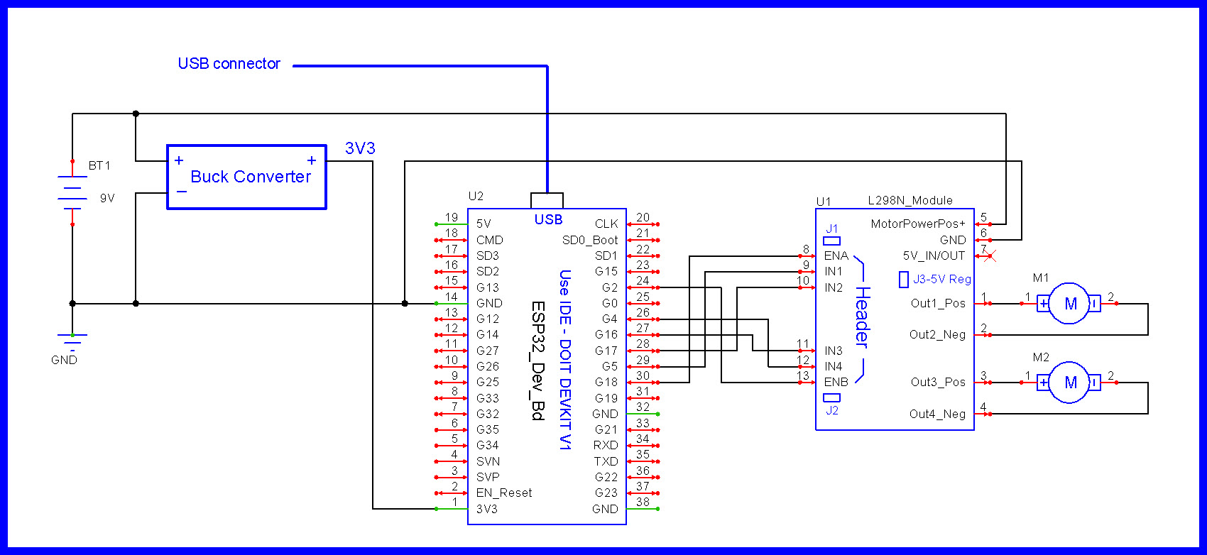

I’m building a small car controlled via a PS4 controller. The software works fine, but I’m having hardware issues.
When the ESP32 is powered through its mini USB port, everything works: the controller connects, sends commands, and the motors respond. The motors are powered separately by 4 AAA batteries (6V total) to avoid overloading the ESP32.
However, when I try to power the ESP32 from the same 6V source using an AMS1117 voltage regulator, the circuit initially works but stops when I quickly reverse the motors’ direction. It seems like the ESP32 loses connection with the controller.

Circuit Schematic
I hope the photo makes the circuit layout clear. I apologize in advance for any inaccuracies, as I’m a beginner and this is my first attempt at drawing a circuit diagram.
(P.S.: The GND connected to the ESP32 is shared with the GND of the battery pack. I’ve shown it separately for clarity and organization purposes.)

  • The L298 5v pin needs to be powered.
  • Show us your wiring.

That says you are powering both the ESP32 and motors from the same power supply. That is a no no. We probably get this problem once a day.

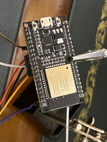

About the wiring, I couldn't find a website that lets me draw wiring circuits, I took some photos instead, if you can send me the link to one I'll be happy to draw it there
wiring
I'm sorry if they're not so clear

I understand, as I mentioned, I'm a beginner, and since I plan to include this in a project, I liked the idea of using a single power supply for the entire system. Is there really no way to do this? Also, it's still not clear to me why this is a problem in the first place
I thought about it, but I couldn't figure out how... The problem I'm having is mostly due to the fact that I want to use a single power supply for everything, and I was not so sure if purchasing another voltage regultor was the right solution. Now, after what @wittrup said, I'm not so sure if this is even possible
  • See by the wiring image which L298 you have.
  • This should work for you:
Do not connect the USB cable while the ESP is being powered by the L298N
It is possible to use a single PSU, but you need a much more powerful PSU. 4 AAA is puny. The reason is motors cause dips in voltage which can cause the ESP32 to re-boot. Since it's a car, a mains powered PSU is out of the question and you need batteries. This means you can use the AAA to power the ESP32 ONLY, then get 4 genuine 18650 type Lithium batteries (NO parallel) . Also, do not use the old inefficient L298N, get a mosfet type like TB6612FNG. Of course now you will need a proper Lithium charger like a SkyRC M3000
  • And powering the L298N with 6V batteries (aim for 7-9 volts) will not properly power the onboard 78M05, 5V voltage regulator.

I tried the circuit LarryD designed (with the only modification being the use of 7 AAA batteries, since with fewer I couldn’t get the controller to connect), and it works much better than my setup. However, unfortunately, I encountered the same issue after some time: as you predicted, the ESP32 reboots due to voltage dips.
I then followed your advice and tested the setup, using the 4 AAA batteries to power the motors, and another set of 4 AAA batteries connected to an AMS1117 3.3V voltage regulator to power the ESP32. This configuration works perfectly! I’ll definitely look into the specific batteries you recommended.
Regarding the motor driver, you're absolutely right. I initially bought the L298 when I didn’t know much about motor drivers, but now I plan to switch to more modern ones, like the TB6612FNG you suggested.
I’m really happy that this setup works, though I do wish I could have used just one power supply for everything.
