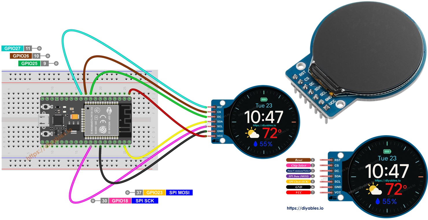

The strange fact is that the sketches (blink and printing some text to be read in serial monitor) work fine while if I try to connect a display (I used a round TFT 240x240 with GC98A01 driver) at the first I was able to display text in different colors by using Adafruit_GC98A01A library ( but TT-eSPI was not working even when I downgraded the ESP core to 2.0.14 version), then stopped working.

How about trying this library: GitHub - DIYables/DIYables_TFT_Round
It is has a lot of tutorials and examples. The below is one:
