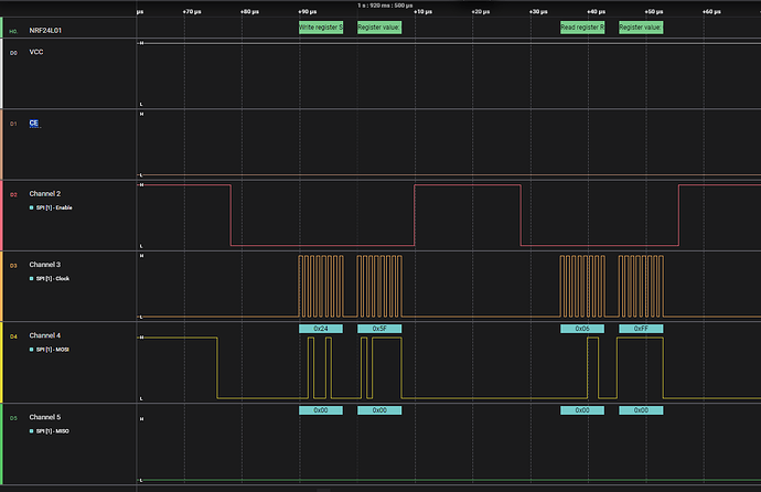

Do you see any activity on the SPI bus at all using a scope? If so, how's signal integrity look?
Not sure what it should be, but using scope:
CE pin remains low.
CSN pin is high, very short drop to 0 when querying the board, then back to high.
SCK pin: Not sure if this is correct. Getting very short spaced bursts of 11.8Mhz pulses ie a burst of 8 oscillations at 11.8Mhz, then a few uSec of nothing, then another burst. The pulses look untidy ie ramps up to 2.24V and then sawtooth oscillation between 1V and 2.24V for the 8 or so oscillations then decays back down to 0V. Zooming out I see a general pattern of a similar envelope to the MOSI signal. Thinking about it, this looks like its pulsing at the MCU clock speed.
MOSI: 0V , then 2 pulses @ 3V3, then about 6ms delay, then a series of pulses for around 3.5ms.
MISO: 0V constant.

Okay, so I took some data grabs using my Logic Analyser. In both tests I used the same NRF24 module to rule out the case of it being faulty. I also swapped out the ESP32 module, no change.
Channels:
0: N/A
1:SCK
2:N/A
3:MISO
4:MOSI
5:CE
6:CSN
Connected to an Arduino Mini MCU:
Zoomed to 100ms intervals:
Zoomed to 1ms intervals, intial packets:
Connected to ESP32 C3:
Zoomed to 1ms invervals, intial packets:
The Mini works fine and the serial output is populated correctly ie communicates fine with the RF module.
On the ESP32, there is just no traffic/response on the MISO channel. I actually did the test on the ESP32 twice, once with the analyser connected to the pins of the ESP and the other to the pins of the RF module. In both cases, the logic pattern looked basically identical. Just wondering if there could be something holding the MISO down to ground somehow.
So just for fun, I wired (jumpered) the Arduino Mini into the board I made for the esp32 and got the following serial response:

which looks like it is talking to the RF module. So it looks like it may just be a coding issue or something with the ESP's SPI interface :frowning_face:
Hi, I have managed to find better analyser software for my scope which allowed for SPI and NRF24 packet anaysis.
Using the Pro Mini MCU, I get this result for the first few bytes:
And for the ESP32:
From this I can see both have the same clock signal and the same MOSI output data, but only the Pro Mini Arduino gets a MISO response. (I have also tried disconnected the MISO pin from the ESP32 to see if it was being held low by the ESP, but it made no difference).
Looking at the signals closer I note 2 differences. The MOSI signal remains high after each byte of data on the ProMini whereas the ESP32 keeps it low. Based on the clock pulses this should not make a difference, however I see the CSN on the ProMini activates (goes low) when the MOSI is high, whereas MOSI is low on the ESP32 when it activates. Would this impact at all to anyones knowledge?
The only other difference I could find was that although both clock signals are at 1Mhz (I slowed the SPI down from 10Mhz to 1Mhz) , the ProMini has an almost exact duty cycle of 50% whereas the ESP was tending towards 58%.
I have now also swapped the ESP32 C3 out with a NodeMCU ESP 12F module and it behaves in the same way as the C3 ie output patterns match and still no response on the MISO channel. I found an example (https://how2electronics.com/esp8266-nrf24l01-gateway-arduino-node/) where this module was used with the NRF module, but they used the RH_NRF24 library instead. The only issue I have with that library is that it doesn't have the same report function as far as I can tell which makes this a bit more of a blind test.
