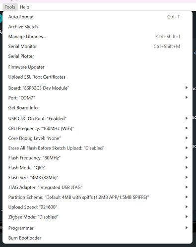

I'm being driven mad by my custom PCB with a ESP32 C3 WROOM module, I'm connecting direct to the USB of the module and have been flashing it without any issues and receiving data back into the serial monitor on Arduino IDE 2.3.3.
I have an accelerometer SC7A20 connected via I2C and using serial.print() to view the data, yesterday I tried to edit the code to include an OLED display on the I2C without success (in another post), I then removed all the OLED code and went back to just the Accelerometer code but I cannot get any serial output any more.
Here are my settings
I have USBCDC on boot enabled but I get nothing whe I use the following code, whereas I have previously.
I have tried some other code with serial output which seems to work, maybe I've messed something up from my original working code and caan't see it.
Any suggetions?

I have never seen that Settings panel but it sounds like the Serial port is disconnected somehow.
