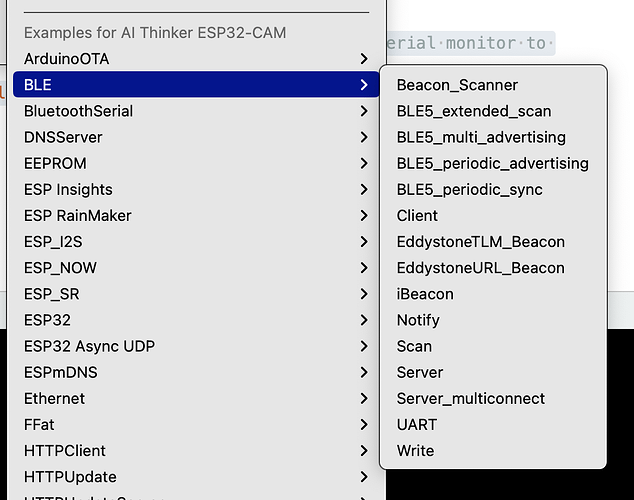

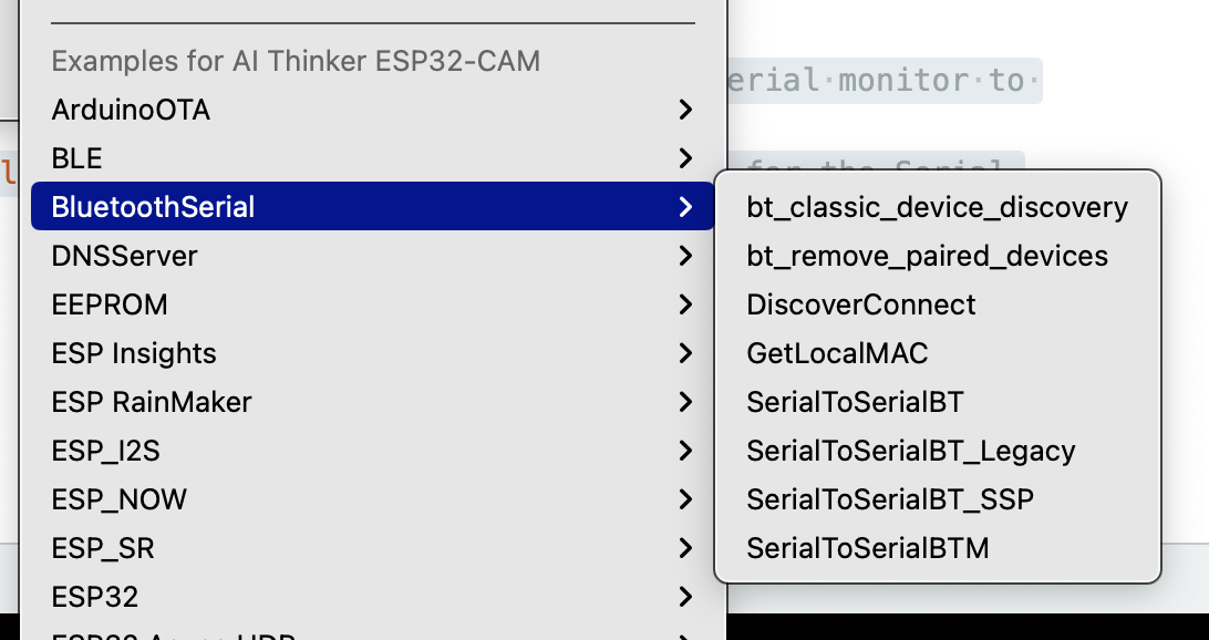

Lot's of examples for the esp32cam board, here is a couple screen grabs.
Witch one should I select?. I use app inventor for android app.
I want to control a robot
There is no thing about it
Bluetooth Classic is the simplest to use
using SerialTiSerialBT the robot could receive serial messages from the Android phone
you could initially test it with a Android Bluetooth Serial app by typing commands to be sent to the robot, e.g. you send "turn right" the robot receives it as string and checks what the command is
you can then implement an app to send commands in response to pressing a button on the screen, etc
