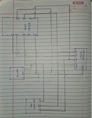

A wiring diagram would help
Give me 5 minutes Jim. I am drawing it.
No hurry, please take your time
Circuit Diagram
Your FT231 module does not have a 3.3v output
FT231 does have a 3.3v (3V3) output also mentioned in diagram
Sorry you are right

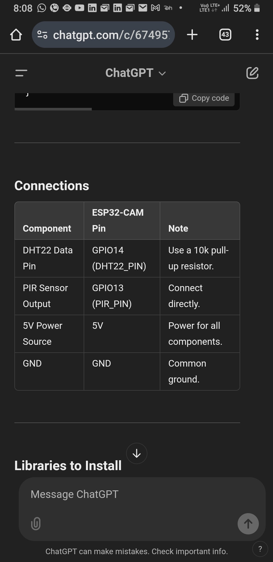

I see in the diagram you are using IO13 and IO14 but in the code you are usinp GPIO33 and GPIO4.
